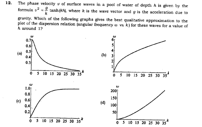

## v = \frac { \omega } k ##
## \omega = \sqrt{ kg \tanh (k) } ##I have no idea to guess the graph.
I put g = 9.8 and tried to calculate ## \omega ## for different values of k.
## \omega (0 ) = 0,
\omega (30) = 17.15
~~\omega (20) = 14 ##
But, these values don’t match any of the graph.
So, what to do now?

You missed a factor of ## h ## in ## \tanh (kh) ##. (Editing: Oh I missed the part ## h=1##). One problem with trying to rely on numbers on the axes here is they don't label their units, so you don't know what number to use for ## g ##. ## \\ ## A hint that should help: What is the functional behavior of ## \tanh(k) ## for large ## k ##? Thereby, what does ## \omega ## vs. ## k ## look like for large ## k ##? ## \\ ## Also, what is the slope for very small ## k ##? Is it some constant or is it zero? (Hint: Expand ## \sinh(x) ## and ## \cosh(x) ## in Taylor series for small ##x ##). ## \\ ## You could also try using ## g=980 ## cm/sec^2 , but for this problem, I think that leads you to an incorrect answer.

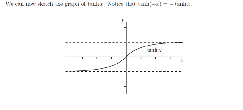

I didn’t know the graph of ## \tanh ( k ) ## and I don’t want to look for it right now. 1st I want to solve this question with the knowledge I have and then I will look to the graph.
## \tanh ( k) = \frac { e^k - e^{-k} } { e^k + e^{-k} } ## ...(.1)
As k tends to infinity, ## \tanh ( k) ## tends to 1.
So, for very large k, ## \omega \approx \sqrt{ kg} ## ...(2)
So, as k goes to infinity, ##\omega## should go to infinity . ...(3)
(b) and (d) fulfils condition (3).## \tanh ( k ) = k \frac { 1 + \frac { k^2}{3!} +…}{ 1 + \frac { k^2}{2!} + …} ## ...(4)
So, for small k, ## \tanh ( k) \approx k ## ...(5)
## \omega \approx k\sqrt{ g} ## ...(6)
So, ##\omega## goes from ##\sqrt{ g}## k for small k to ##\sqrt {gk} ## for large k. This is shown by (b).
So, the correct option is (b).
Is this correct?
Correct=I would pick (b) also. A couple of things to observe: For large ## k ##, ## \omega=\sqrt{g} \sqrt{k} ## so instead of looking like a straight line, the second derivative will be negative. ## \\ ## Also for small ## k ##, ## d \omega /dk=\sqrt{g} ##, rather than 0. ## \\ ## (d) comes close to working in some ways, but the second derivative in (d) is slightly positive for large ## k ##.

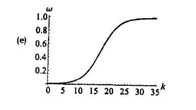

Not that I know of. I thought of one additional feature though that helps to show (b) is correct: For large ## k ## (in this case even 18 is large), ## \omega(36)/\omega(18) ## needs to be approximately ## \sqrt{36/18}=\sqrt{2} ##. This would rule out (c).
That's a nice idea to get rid of g.
Then I can have one ratio for small k and another ratio for large k and see which graph meets this ratio. If I got one meeting this ratio, then surely this will be the required graph.
I see that tanh (k) ≈ k is a good approximation for k < 0.5,
tanh (k) ≈ 1 is a good approximation for k > 10.
Now, small k approximation is not useful here due to scale of the graphs. So, one can use large k approximation to eliminate some options.
