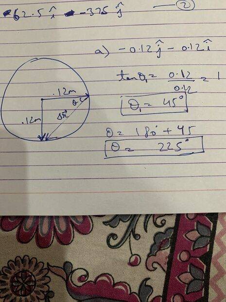

The minute hand of a wall clock measures 12cm from its tip to axis. The magnitude and angle of the displacement vector of tip are to be calculated for three intervals. What are the A) magnitude and B) angle from quarter after the hour to half past, C) for next half hour and D) for the hour after that?
Delta r= r2-r1
I calculated the angle as 225 whereas answer says something else.

Please show your work, and please re-post your image rightside-up and scanned at higher quality so we can read it. Thank you.
Assuming:
- the +x-axis runs from the dial’s centre in the direction of 3 o’clock (for a 12 hour clock);
- angles are measured anticlockwise relative to the +x axis;
then I agree: the angle of displacement of the tip from quarter past the hour to half past the hour is 225º.
What is the ‘official’ answer?
Also, note that your homework statement in Post #1, has 4 parts (labelled A to D). But the image of the question from the textbook shows 6 parts (labelled a to f).

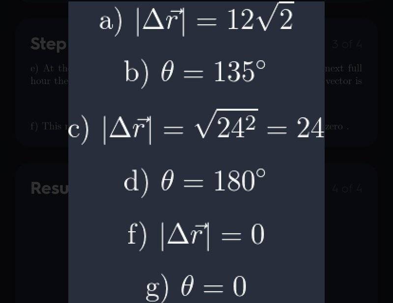

You can follow in image numbering.
Here are some comments on the ‘official’ answers in the Post #5 attachment. Just my opinions though.
The units for the magnitudes of displacements should be cm. The units are missing (a very basic mistake!).
a) ##12\sqrt 2## should be ##12\sqrt 2## cm.
b) 135º only makes sense if the angle is measured anticlockwise from the 12 o'clock direction.
c) ##24## should be ##24## cm.
d) If the angles are measured as for part b) (above), then the answer should be 0º, not 180º.
e) Answer ‘e’ is mislabelled ‘f’ but is correct.
f) Answer ‘f’ is mislabelled ‘g’. Since the displacement has zero magnitude we should really say ‘θ is undefined’, not θ = 0.
What text-book/source are these questions/answers from?

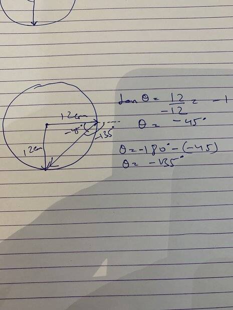

This is the fig. The angle should be -135.
Also it is coming -45. Is it right? Because we take - angle when measuring clockwise.
Also this 180 degree doesn’t make sense. Because we measure angles from +x axis
Or if measured clockwise from 3 o'clock.
I make it 90° if measured anticlockwise from 3 o'clock. The given answer seems to be the rotational angle undergone by the hand, not the orientation of the displacement vector.
Every angle of the displacement will be measured from 3 or +x axis. @Steve4Physics is walking on different path.
For the first sweep the angle should be -135. For second and third it should be 90.
But the answer says different.
The answer given are measuring the sweep angle , the angle between the arms (well there are not two arms, you understand) but we have to find the angle of the displacement vector.
Yeah!
