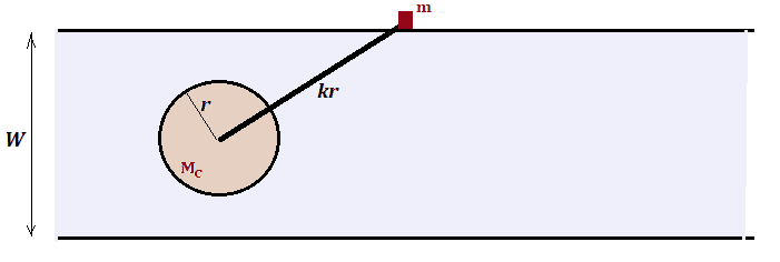

There is a raft in the middle of the river. The mass of the raft is negligible, and it carries a crane on board. The crane moves boxes of building material of mass m from one river bank to another. In one cycle, the crane loads material at one side of the river, rotates to the other river bank, unloads the material there, and rotates back. Calculate the smallest value of angular displacement of the raft from its original position during one cycle. Approximate the crane by a homogenous cylinder of mass Mc and radius r, and a rotating jib in the shape of a slim rod of length kr. Assume that the velocity of the river and the „friction“ between the raft and the water are negligible.
torque1+torque2=0
What is meant by "the smallest value of angular displacement of the raft from its original position during one cycle"? I understand that I am supposed to solve this problem using torques of the crane and and of the boxes, but I am totally confused by that "smallest angular displacement". If it was the biggest angular displacement, I would understand it, but this is just strange. What does it mean?
I suppose I should use an equation that torque1+torque2=0, then the crane is stable. Torque1= Mga (a = distance of the gravity force Mg from the rotation axis ). Torque2=-mgb (b= distance of the gravity force mg from the rotation axis). But what am I to calculate anyway? I only need to know what that weird angle is.

My interpretation is this...
I think ‘crane’ is a misnomer. It isn’t meant to do any vertical lifting or lowering. It can be thought of as a simple horizontal rod: one end is attached to the centre of the top of a cylinder (axis of cylinder vertical); the rod is only able to rotate in a horizontal plane.
A mass is attached to the free end of the rod.
The rod is rotated 180º (in a horizontal plane) carrying the mass to the other bank.
The mass is then detached and the rod is rotated -180º (in a horizontal plane) to return it to its starting position.
The cylinder is fixed to the raft and they rotate together. As the rod rotates clockwise the cylinder must rotate anticlockwise so that the system's angular momentum remains zero.
Here's an interpretation that makes for a nice problem.
Assume that the length of the jib is variable via the parameter##k##. If the jib is longer than half the width of the river, then the jib will not need to rotate through 180 degrees to move the load from one side of the river to the other side. I believe you can work out the amount of counter-rotation of the cylinder as a function of ##k## and the ratios ##m/M_c## and ##r/W##, where ##W## is the width of the river. There will be a value of ##k## that minimizes the counter-rotation of the cylinder.
Of course, this interpretation might not be what was intended.

Here's another option: assume that the raft is anchored in the middle of the river such that it can't translate through the water but it can freely rotate in the water.

To avoid subscripts I will call the angles α (the angle to be minimised) and β.
If the raft counter-rotates α on its own axis, what is the rotation angle β of the raft+boom+load system?
What width of river will be traversed by the load?

Suppose the crane cylinder was just as wide as the river? In other words W=2r in the nice rendition by @TSny in post #8?
What are you suggesting? A way of preventing the linear displacement? But in that case, why not just anchor it to the bank so that it can't rotate either?

Since the original wording asks to calculate the minimum angular displacement I think it assumes no linear displacement. If we assume ##m<<M_c## we can ignore the CM translation and assume everything just rotates around the axis of the raft/crane. One way of minimizing the angle of the jib is to shrink the river to ##2r## for a given k.
