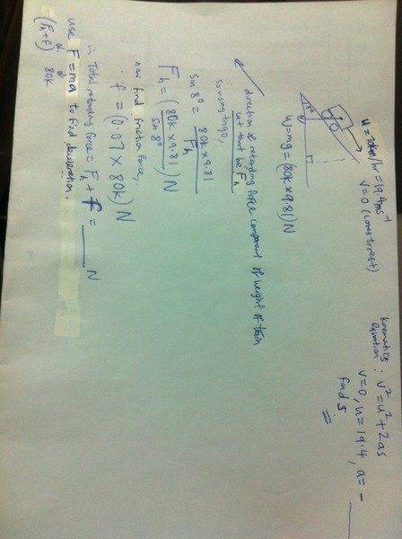

So gravitational force slowing train down is 80000 x 9.81 = 784800N?
I can't calculate the force retarding the train using trigonometry as I only have 1 angle, no distances yet?
I know it seems like I am just being lazy here but I don't have a clue when it comes to mechanical physics, I don't have the ability to understand yet what affects what, what can add up and can't etc I need to have completed this coursework for this coming monday (and I am away for 2 days after tomorrow), I am starting to panic a little now so that's not helping,
I really appreciate everyones help so far, I ideally need someone to dumb everything down for me :confused:
Did this even though its not tested and i' m rushing to study for exams but oh well :D you helped me a bit there in circuits too
Thanks, I only needed a hint on order of equations to be used and how to be implemented, that drawing is pretty much exactly what I drawn,
However, I came to an answer that does not seem correct, my workings are below,
Retarding force = 80000 x 9.81 / sin8 = 5639020.7N
Friction Force = 80000 x 0.07 = 5600N
Tot Retarding force = 5639020.7N+5600N = 5644620.7N
F=MA so
A = F/M
so A = 5644620.7N/80000 = 70.6m/s
V2 = u2 + 2as
So;
s = (v2 - u2) / 2a
So;
s = 02 - 19.42 / (2 x 70.6) = -2.665m
I change -2.665m to positive 2.665m, because it is deceleration not acceleration.
This however doesn't seem right, where have I gone wrong?

Why wouldn't it seem right? Hmm. You have to use 19.444 m/s though. More accurate
Because its negative? Your acceleration should be negative btw. Unless you put deceleration

Seems like you have no idea about free body diagrams.
There are three forces acting on the train: gravity, the normal force N from the track (i.e. acting at right angles to the track), and the tractive resistance T, acting parallel to the track.
The trick is to 'resolve' the forces into their components in two directions at right angles. In this case, I would choose parallel and perpendicular to the track.
The tractive resistance is easy: that all acts parallel to the track so has no component in the other direction.

I have attached my FBD,
I honestly have not been taught this particular thing using free body diagrams etc, I have also not seen some formula needed.
I have done F=MA and the distance/acceleration/velocity formula though, however, putting them altogether is a totally different thing to me as I am not confident with merging the formula like I am with electrical formulas for instance.
I have however came to a reasonable answer.
Tractive force = 0.07 x 80000 = 5600N
Normal force = 80000 x 9.81 x sin8 = 109223N
Total Retarding Force = 5600N + 109223N = 114823N
A = F/M
A = 114823/80000 = -1.435m/s (negative for deceleration)
s = (02 - 19.42) / (2 x -1.435) = 131m
How does that look?
Or is it cos 8 in the normal force calculation?
I feel like I'm being a pain, please assure me I am not haha
Thanks!
You could solve this using energy and work.
Watch the units: -1.435m/s2
Bingo.
