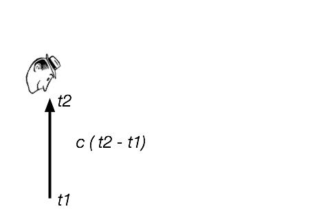

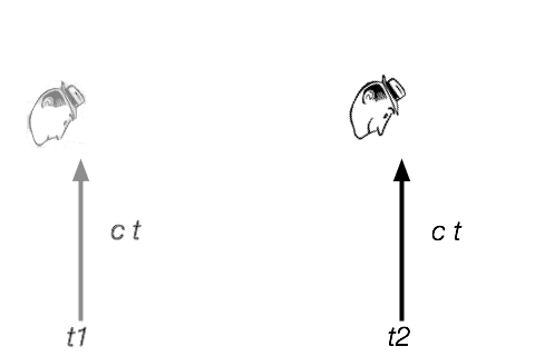

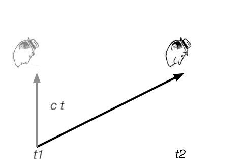

I am confused about something. Consider the following situation:
An alien with spectacular vision (that can resolve time differences on the order of 10^-12 seconds) is in a train that is stationary and is looking at a light that is very briefly pulsed on-off about a meter away from his eye. The light is pulsed at time t1 and he perceives it at t2.( even though it has been off for a long time by then). Now consider the situation when the train starts to move.
The alien sees the same event. There are no windows and there is no way the alien can get information from outside the cabin. According to the fact that the train is not accelerating but moving at a constant velocity, nothing the alien can do should tell him that he is moving. But consider which photons the alien is seeing.

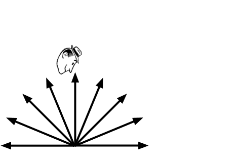

When the light is pulsed, the photons go in all directions. In a stationary train, the alien sees the photon going straight up, but in the moving train, the photon that reaches his eye, is the one that takes off from the light at an angle.

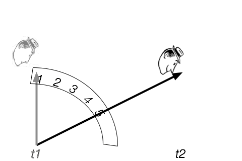

Now make a stencil with numbers cut out on it like so:
and put it right over the light like so:
Please forgive the scale. I wanted to make the numbers readable so I made the mask very large. You might be tempted to say that by the time the light pulse traveling obliquely reaches the mask, the mask will have moved so the alien will really see a different number (2 maybe?). But make the mask really small so it is really close to the source. And make the stenciling really small so you can resolve small differences.
When the train is stationary, the alien sees the number '1' but when the train is moving he sees the number '5'. Again, remember, the mask is really, really close to the light source. If the mask were really big the way I drew it (for clarity) then the alien would always see the number '1'.
So it seems to me that such a 'light speedometer' can tell us how fast our frame of reference is moving even without any information from outside our frame. It relies on the fact that we know the speed of light is constant in all inertial reference frames. This seems to suggest that we can distinguish inertial frames of reference. It goes all the back to the idea of Newton who spoke about absolute reference frames here
If he sees a 1 when the train is stationary, then he sees a 1 when the train is moving inertially. The size of the mask doesn't make any difference.
@ Dale The alien CANNOT see a 1 because the photons from the light pulse that carry the '1' information are going straight up. By the time those few photons reach where his head should be, his head has moved on. The photons that strike his eye at t2 are not carrying '1' information. The only photons that reach his eye at t2 are traveling obliquely. All photons intercept the mask early in their travel so the oblique ones carry '5' information. This is because at the very beginning at t1, vertical photons are labeled 1 and oblique photons are labeled 5. For simplicity, I postulated a very brief light pulse at t1. When the '1' mask is under his eye at t2, there is no light. The train is not going at the speed of light.
You are (wrongly) assuming that the scale is not moving. It will go through one because the scale (and therefore the one) moves with the train. If the scale does not move with the train, it will not go through 1, bit the alien will attribute this to the scale moving relative to him so it is no longer the same experiment.
This is nothing but abberation of light - it travels in different directions in different frames. You can obsreve abberation when you drive on a rainy day - all the rain seems to be coming from the front, but in the Earth rest frame it goes straight down.
@bwana - DrGreg's answer is correct. Your last diagram is wrong. It shows (viewed from an inertial frame in which the train is moving to the right) where the alien is at the time of the emission and where it is at the time it sees the pulse. But it only shows the stencil at the time of emission, not at the time the pulse passes it. If the number 1 is a fraction ##f## of the height of the train above the source, the travel time of the light is ##\Delta t##, and the horizontal travel of the alien in that time is ##\Delta x## then the light pulse will be at the same height as the 1 at time ##f\Delta t##, at which point the 1 will have moved horizontally ##f\Delta x##. In other words - right on your diagonal ray.
You can't get out of this by making ##f## small, which is what I think you are trying to do. You can only avoid it by making ##f=0##, in which case all the numbers are in the same place and the ray goes through all of them.
You seem to forget that the mask is traveling at the same speed too. If he sees a 1 at rest then he sees a 1 at any uniform velocity. The 1 selects obliquely moving light when it is moving. You should work out the math on this.
The size of the mask and it's distance to the source are not relevant.
