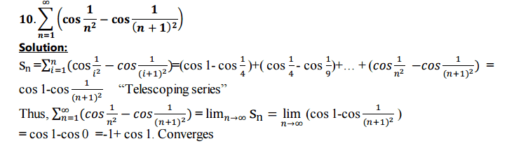

Can I use the divergence test on the partial sum of the telescoping series?
Lim n>infinity an if not equal zero then it diverges
The example below shows a telescoping series then I found the partial sum and took the limit of it. My question is shouldn't the solution be divergent? Since the result -1+cos 1 is not equal to 0? I'm confused.
it is ##a_n## must tend to zero, not the sum :)
what's ##a_n##?
a term of the series
How can I determine convergence/divergence for telescopinc series then?
you have already done this
I haven't? the solution is above, however I don't quite understand. I want a general rule to detect convergence/divergence fore telescoping series.
The series ##\sum (b_{n+1}-b_n)## is convergent iff the sequence ##b_n## is convergent
but he didn't find the convergence of bn sepeartly in the solution above?
He restored the proof of my proposition for this concrete example
