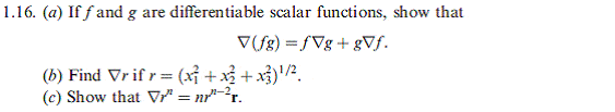

In your defence: The original problem formulation is confusing because it uses a boldface r in the 1/r. Many of us are conditioned to see that as a vector.

Dear BvU, I think Author referred it as a vector. In the book (Mathematical Methods for Physicists by Tai L. Chow) scalars are mentioned as non bold, such as in same exercise page other problems are
I count it as a misprint. What could possibly be the interpretation of ##1/\;\vec {\bf r}## ?
