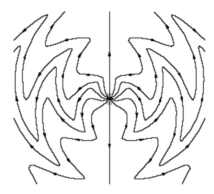

Do Electric field lines propagate by themselves away from a charge?
The discussion revolves around the propagation of electric field lines in relation to a moving charge, particularly focusing on the formation of kinks in the electric field due to acceleration. Participants explore conceptual understandings rather than mathematical formulations, seeking clarity on how electric fields behave as charges move and accelerate.
  • One participant proposes a pictorial understanding of electric field lines and questions whether they move outward while also moving in the direction of the charge.
  • Another participant argues that electric field lines cannot be labeled or identified over time, suggesting that a static electric field does not propagate or have a velocity.
  • A different viewpoint introduces the concept of retarded potentials in the Lorenz gauge, indicating that these may behave differently than electric fields.
  • There is a discussion about whether newly emitted field lines are created during acceleration or if they existed prior to the charge's movement.
  • Some participants express frustration over the inability to visualize electric field lines in a meaningful way without labels, while others maintain that the labels are not physically meaningful.
  • Several participants reference an external animation to illustrate how electric field lines shift and kink after a charge is accelerated, suggesting it may clarify the discussion.
Participants do not reach consensus on the nature of electric field lines and their propagation. There are competing views on whether field lines can be labeled, how they behave during charge acceleration, and the relevance of retarded potentials. The discussion remains unresolved with multiple perspectives presented.
Participants acknowledge limitations in their understanding and the difficulty of visualizing electric field behavior without a clear framework for labeling. The discussion highlights the dependence on conceptual models and the challenges of reconciling different interpretations of electric field dynamics.
  • #31
renormalize said:
In the limit of an infinite number of infinitesimal kinks, the result is no longer a kink. It's a smooth curve that interpolates between the E-field lines before and after the smooth (non-impulsive) acceleration.
If kinks are not produced in realistic examples(real world),
Question 1: why does every animation actually show it ?
Question 2: Then whats EM wave if not kinks ? Something going out from charge which is what if not kink ?

Why are you focused on these kinks at all? It is a non-realistic wave. You will be much better off learning about realistic waves like sinusoids.
Your focus on kinks is leading you into all sorts of misunderstandings.
-The static E field does not have a speed
-E field lines do not have an age
-There is no identification of points along a field line
-There is no identification of field lines at different points in time
I don’t know if you have been exposed to some horrible reference that it putting all this into your mind, but you really need to try to mentally clear what you think you know and start fresh. What you are describing here is unrecognizable as electromagnetism to me.

  • #47
Are you familiar with the concept of a potential?
They are less complicated and easier to understand than fields. Waves in the potentials are almost trivial, and if you need the fields then it is just some math to go from the potentials to the fields.

The nice thing about the potentials is that (in the Lorenz gauge) they are very cleanly related to the charge and current. You don’t need to trace any field lines or make any connections.
For any charge you can think at each moment in time it sends out a spherical scalar ”bubble” that expands outward at ##c##. This wave is proportional to the charge density, and it decays as ##1/r##.
Similarly, for any current you can think at each moment in time it sends out a spherical vector bubble” that expands outward at ##c##. This vector wave is proportional to the current density, and it decays as ##1/r##.
This is very straightforward to visualize. If there are multiple charges or currents then the potentials just add together.

  • #60
gionole said:
I understand what wave is in medium for sure. Energy travels in a rope as each molecule goes up and down. This seems easy.
Energy travels in the EM field wherever ##\vec E \times \vec B## is nonzero. So if you understand a rope wave by focusing on energy traveling, then you should do the same for EM.
gionole said:
Sound waves are understood as well, as each molecule hits next one "horizontally". So in the end, energy travels from one point to another and each molecule does something(moves up/down or right and left - just talking only about rope and sound for this).
Again, you understand by looking at energy.
gionole said:
But I realized I couldn't understand the EM wave the same way as I did the rope/sound example, since it travels into vacuum,
What has that got to do with anything? The EM fields still transfer energy just like the rope and the sound. The problem is that you abandoned a sensible approach for understanding waves, looking at the energy, and instead focused on the E field lines. That is a useless approach here.
gionole said:
so when I got exposed to kink, I thought it was easier to move to this way and here I'm.
And now that you have found it is not easier, why do you persist in going down this unfruitful path?
gionole said:
But if we even forget the "kink", we can still see in the realistic case that some shape is formed which moves outwards with speed of light.
Yes. This is an EM wave.
gionole said:
As I understand the shape is formed with the following reason. The charge moved from `x1` to `x2` with increasing speed, however now you wanna put it, it's undisputable that the lines that constant moving speed charge had till x1 still would move with old speed,
Field lines do not have a speed.
gionole said:
so once charge appeared at x2, the old field lines are not at x2.
Field lines don’t have an age. There are no old or new field lines.
gionole said:
they're a little bit distance away. Take a look. https://ibb.co/SsQVpFt (you can see here old field lines didn't catch up to x2 due to speed change - even though you say speed change is not discrete, there still should be produced the following scenario as on my link).
I don’t understand that drawing. But I don’t need you to fix it. I prefer to abandon this whole approach.
gionole said:
Now, as far as I understand, from my image, we get curved line instead of straight line. Is this correct ?
The E field lines for an EM wave are indeed not straight.
gionole said:
if so, I have to imagine why curved line and not straight line would be produced and why that curved line wouldn't be produced with instantenous change speed.
And once you succeed in that, what have you gained? Do you think this produces an understanding of EM waves? Maybe it does. I haven’t seen anyone try this approach, so I cannot say that it will definitely fail. It just seems like there has been no progress so far using this approach.
Why not take a break from it for a while. Either pursue the energy approach or the potentials approach for a bit. See if a different approach helps. If it does, great, if not then you can always come back to this approach.
