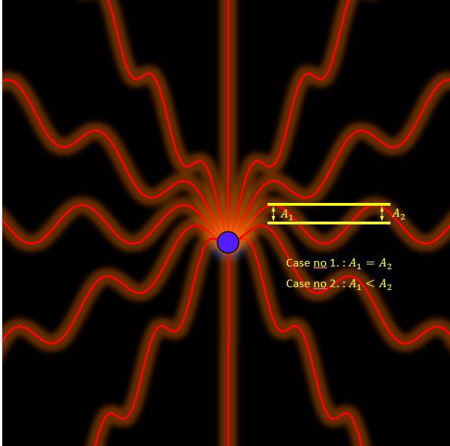

The last couple of days I’ve been troubled with a specific part of electromagnetism. How will electric field lines be affected by an oscillating charge? More specific, what will happen with the “amplitude” of a wave in an electrical field line as the wave propagate away from the charge?
1. Will the amplitude be unchanged as the distance increase?
2. Will the amplitude increase as the distance increase?
When such wave propagation is described in figures / illustrations I actually find both cases (hence the confusion). Below you will find a short video that simulates case no.1 (no increase in amplitude with distance) using excel. I suspect, however that this is an incorrect description..
What do you mean by amplitude here? You have a varying electric field strength at each point.

The term "amplitude" may be a misleading. I've tried to illustrate the two cases in the figure below:
##A_1## and ##A_2## are distances between points in space, aren't they? Or, am I misled?
Yes - the figure has two spatial dimensions
Those aren't amplitudes. The electric field is everywhere in space. The thing that varies is the field strength at each point. That oscillates in strength and direction as the charge oscillates.

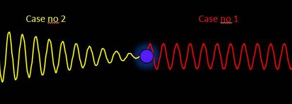

I trully apologize for being unclear. Below I’ve made a new attempt to illustrate my question (I'm only concerned with the electrical field lines).
Let’s say we have a charge that oscillates in vertical direction. The oscillation disturbs the electrical field creating a wave pattern. How will this pattern propagate in space? For simplicity I've only included the electrical field lines in the horizontal directions (although they off course are everywhere).
You may be missing the point that electric fields lines are only illustrative. There are no discrete lines - the field is continuous across space. Whatever lines you choose to draw are arbitrary. In particular, those apparent amplitudes are not anything physical. An electric field line is not a physical thing. It's just a diagrammatic tool to help you visualise the field direction at each point.

The single field line that you measure there just represents how the direction of the E-field vector changes. But for the amplitude of the EM-wave you also have to consider the magnitude of the E-field vector, which is represented by the closeness between neighboring field lines. You cannot just look at a single field line for this.

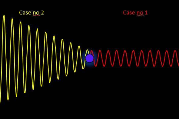

Thank you for all the response and I really apologize if my question appeared unprecise. It is likely due to both poor English and inadequate understanding / theoretical background.
Nevertheless, from what I understand the E-field lines may be understood as curves drawn through space so that its tangent at any point is in the direction of the E-field vector at that point.
So if we are to consider these E-field lines separately (i.e. not radiation, EM-waves etc.) - how will any patterns in these E-field lines develop as they propagate from an accelerated point charge? For instance, in the case we have an oscillating point charge, the E-field lines will form a wave pattern. How will characteristics of these wave patterns (e.g., amplitude) develop with distance from the point charge? As far as I understand there are three possibilities:
1. The wave pattern continues unchanged with distance (case 1)
2. The wave amplitude increases with distance (case 2)
3. Something else happens :nb)

You cannot see the amplitude in field line diagrams. All they show is the direction of the field at each point along the field line (and if you are interested in a point off the field line you just draw another field line through that point).
Case 2 is more correct. But the yellow field line should come out from the side like in your first picture:

The amplitude decreases as I said above. The amplitude decreases as 1/r and the intensity decreases as 1/r^2.

The separation of the field lines from place to place tells you the relative field strength, no?
It seems to me that the very first diagram is along the right lines (sorry - unintended pun there). If the charge at the centre moves then there will be a change in their direction. Move it fast enough (say up down) then the density of the near vertical lines will vary a bit and the direction of the near horizontal lines will change up down. The propagation delay will mean the lines are 'wavy'. So the modulation will be a combination of amplitude and direction. But the waviness is not a plane wave.
