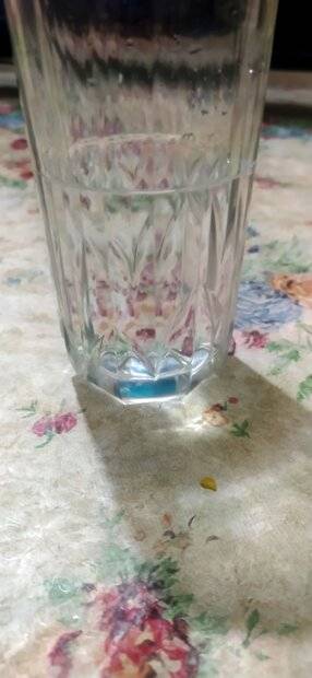

It looks like this (image 1):

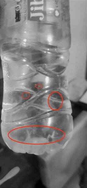

After filling my water bottle. I didn't drink from it and just left it untouched in my bag. After few days I took it out and it looks very unclear and some dust like metarials are floating inside the water.
This is how it looks like (image 2) and here I marked them incase they might be unnoticeable because of the image quality (image 3):

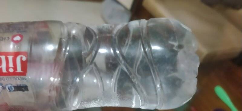

I did the same with the water I have at home and it is totally clear.
Here it is (image 4)
So if I leave a water collected from a recycling filter it has these dusty metarials in it and water which isn't collected from recycling filter is very clear.
My question is that is the water collected from recycling filter contain micro plastic? Is it drinkable? Overall is water recycling filters safe? (or was that specific filter my school is using maybe faulty?)

Hmm I tried touching those little particles and some of them are plastic type and some are like wet dust.
Your comparison wasn't fair since you used a clean looking glass for the tap water and a well used looking plastic bottle for the filtered water. In other words, how can you be certain the stuff wasn't already in your bottle?

DO NOT DRINK IT.
If it was clear when first filled then turned cloudy, the most likely is bacteria growing rather well in the water.
Maybe your bottle was contaminated rather than the water source.
In any case, it would be a good idea to show the cloudy water to someone at the school that has the authority to enforce some action/investigation.

Note: seems to me like you are mostly concerned about microplastic. Don't.
There is plenty of a scary hype about microplastic that is detected everywhere, but first - so far it is not clear if it is in any way dangerous (if it really were it would be long obvious and observed in health statistics, so far we don't see anything like that), second - its amounts are small, it is not like it can be detected just because it drops out of water in visible amounts.
Chemical things that are dangerous/pathogens are typically just compounds with a relatively small molecular mass. These can be present between products of the plastic decomposition, this is well known. But if microplastics are stable enough to survive for many years, amount of decomposition products they produce is very low, which makes related dangers low too. It is dose that makes the poison.

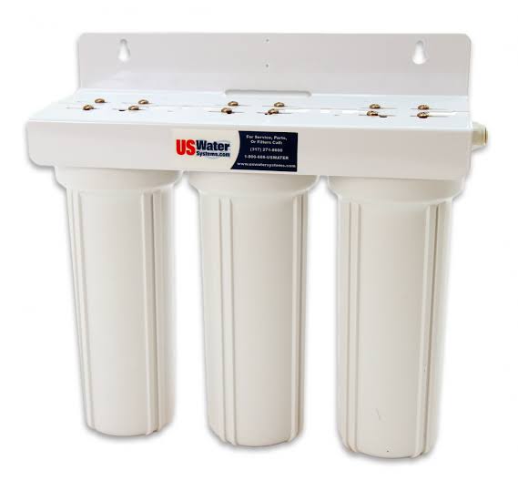

It may just be me, but on the manufacturer (? USWater ?) I could not find that term. Could somebody please enlighten me what that is supposed to mean in the context of this topic?
As far as I know actual water recycling is a far more complex problem than just filtering.
The water was poured from the bottle and I clean my bottle everytime before filling so I am sure it wasn't there when I filled it.
They state that it is a recycling system.
If it's only that filter and really introduced as recycling system and supposed to produce drinking water in a school, then something feels fishy there.
I would try to inquire about that system: what is it exactly, what is the water source and is it really supposed to produce drinking water?

It resembles the pre-filter we had on several DI/RO systems in our QA/QC labs. Depending on season and utility activity, the input quality varied. We had to rely on eg instrumentation limits rather than actual usage. Cleaning, sanitising the components involved a lot more work than simply changing modular filters and membranes etc.
