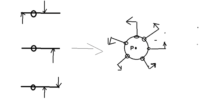

As already mentioned in several posts, the velocity of any point P of the rigid can be decomposed as a sum of two terms: the velocity (usualy called translation velocity) of another point, O and a rotation about this point O. ##\vec{V_P}=\vec{V_O}+\vec{\omega}\times \vec{r_P}## where ##\vec{r_P}## is the position vector of P relative to O and ##\vec{\omega}## is the same for all the points of the rigid and for any choice of the point O. When you change the point O, the translation changes but ##\vec{\omega}## does not. And at any instant you can find a reference point O so that ##\vec{V_P}## is zero. This point is what they call "instantaneous center of rotation" or "instant center of rotation". It is at rest at that instant. It will be just a coincidence if this point happens to be the COM or the CG at some specific time.
This works always for plan-parallel motion (or planar motion). For a more general motion, like an elicoidal one, I think that it does not work. I mean, there may not be any point instantaneously at rest.
nasu said:
And at any instant you can find a reference point O so that VP→ is zero. This point is what they call "instantaneous center of rotation" or "instant center of rotation".
Ah, that is a valid definition. This point may be on or off the object, and it will be different in different reference frames.
user079622 said:
So men in video is wrong when he said if you choose any point that is not at cg you will get wrong results?
I did not watch all the video. but he seems to talk about a dynamics problem. When it comes to momentum and KE, the decomposition into rotation and translation works only for the COM. But this has nothing to do with the discussion in this thread.

@Dale
He forgot in my video to calculate mxa in case where net force in non zero?

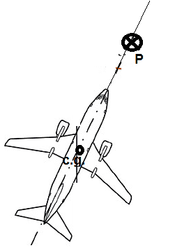

If plane rotate around com ,then from ground frame com travel in straight line. If plane rotate around any other point ,com will not travel in straight line.
I dont know how to express myself, I know when I spin a ball or frisbee, my eyes see that axis of rotation goes through center, I dont know how you call it, maybe I can call it "apparent pivot point"...
If a rigid object rotates with angular velocity ##\omega## about one axis then it will rotate with angular velocity ##\omega## about any other axis.
The com travels in a straight line if there is no net force, regardless of rotation.

Mathematicaly yes, phyiscly not, com is only position on object where ball inside "centrifugal device"(G-indicator) will stay at the middle.
So if airplane really rotate around axis through c.g. when gust hit him, ball inside g-indicator that is placed at c.g. must stay at the middle.
If plane rotate around any other axis, ball will move to side due to centrifugal force.
But ball will move to side due to downwind translation, because wind accelerate plane slightly downwind, later thurst from engine stop this movement.
Do you agree?
So basically my question is; will plane c.g. move in straight line during plane change his orientation when gust of wind hit him?
This is simply not true. The choice of rotation axis does not alter the motion of the ball.
No. The net force is not zero, so there will be acceleration. The motion of the com will therefore not be a straight line at a constant speed.
