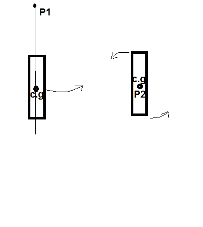

  • #91
Dale said:
This is simply not true. The choice of rotation axis does not alter the motion of the ball.
Left object rotate around P1, ball in g indicator set at c.g. will move out,
Right object rotate around around c.g. ball will stay in center.
This is what I want to say..

  • #94
Let me make sure that I am clear about the drawing. We have two depictions of the same scenario. In both cases, the rod is rotating at the same rate in the counter-clockwise direction.
In the first case, we place the instantaneous cebter of rotation well out north (toward the top of the page) from the rod. The instantaneous axis of rotation is supposed to be stationary. That means that the frame of reference which you have chosen is one in which the rotating rod is moving rapidly to the east. You might imagine the axis along with its rest frame moving rapidly to the west.
In the second case, we place the instantaneous center of rotation in the center of the rod. That means that the frame of reference which you have chosen is one which moves along with the rod but without rotation. Viewed against this frame, the rod is rotating in place.With this understanding in hand, your point is that the two depictions of the scenario yield physically distinguishable results. In one case there is a force detectable by an accelerometer at the center of mass. In the other case there is not. You conclude from this that one depiction is unambiguously right and the other is unambiguously wrong.
This turns out to be incorrect.
The reason it is incorrect involves what we mean by an "instantaneous center of rotation". It is the center only for an instant. It is not permanent. At any later time, there may be a different point that is the new "instantaneous center of rotation".
Because of this, knowing one "instantaneous center of rotation" plus the rotation rate only allows you to know the velocity of every point on the rigid object. Not their future and past trajectories. Not the curvatures of those trajectories. Not any accelerations.
In the case of the drawing you have provided with the spinning rod moving eastward as it spins counterclockwise about an instantaneous center of rotation to the north, the situation would be like a wheel rolling along a wall to the north. The instantaneous center of rotation would always be due north of the center of mass. The accelerometer would read zero.
Just like an accelerometer on the axle of a wheel on a car driving down the highway.

  • #99
This is what I want to say..View attachment 333162
What you seem to mean is a pivot point that remains at rest in some inertial reference frame. This is very different from purely kinematic centers of rotation, which don't care about the reference frame being inertial.
Also note that if a gust hits a plane, it's CoM will not be inertial, so it's not the pivot you are looking for.

  • #101
If I record with camera(connected with earth) plane from top view, plane passes under camera when crosswind hit him.
After I can slow down video, draw line along aircraft in software and find around which point I see rotation.
Let say for this example I find that he rotate around point P.
Yes point P will move on my screen as plane fly,
but distance from P to c.g. will be same all the time..
What is name of this point/axis of rotation?
  • #102
Any point at fixed distance from the com satisfies this condition. The plane rotates around it (if there is any rotation) and keeps the same distance from COM. The tip of the pilot's nose will do, as long as he does not move from his seat.
  • #103

  • #105
A.T. said:
It's called "the point around which user079622 sees rotation".
So this is not that instant center? When I stop video at that time this is instant point around plane rotate..
  • #106
If you look only at the distance from P to c.g., then you are talking about translation of the c.g., not about rotation, because the orientation of the plane plays no role in that.

The first theorem also tell us that the rotation of a body will always be around its CM when there are no external forces applied, because in this case it will be $$0=\sum F=ma_{CM}\Rightarrow a_{CM}=0$$. If the rotation was around another point , then the CM would also rotate around that point which would mean that ##a_{CM}\neq 0##, contradicting that ##a_{CM}=0##.
But that mean object can not rotate around CM if net force0Moon or car in any turn has net force0, ##a_{CM}\neq 0## and CM "rotate" around point(earth) and around itslef(CM), so this statement is not 100% correct?
