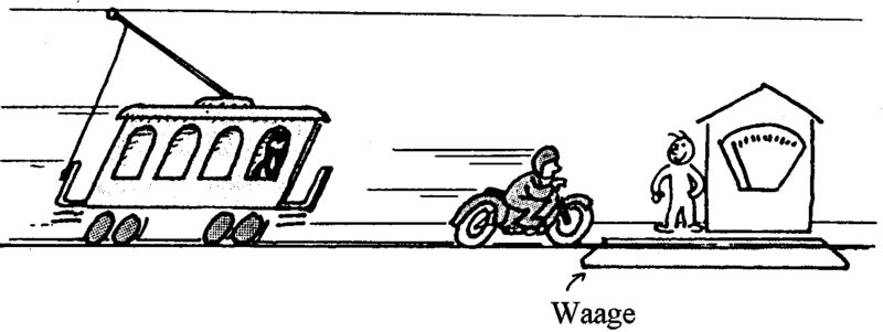

I've just re-read a high school introduction about SR. It introduces the relativistic mass. I know that this concept isn't used anymore in modern formulations of SR, but observations should be the same in all formulations.
They make the following thought experiment: An electric tram and a battery powered motorbike both drive over a scale at speeds close to ##c##. They then argue that only the tram will appear heavier on the scale since it receives its kinetic energy through electricity from the power lines from above, it's an open system. The motorbike though is a closed system, it transforms the energy saved in its battery to kinetic energy, so its total energy and hence mass remain constant.
Is this correct? I remember that the relativistic mass is a subtle issue and one needs to distinguish between longitudinal and transverse mass (which they don't in this text). Wouldn't we need transverse mass here (since gravity works perpendicular to the direction of motion)?

That is basically correct. Of course, if the bike has reached relativistic speeds solely on battery power, that is one special bike.

Let's overspecify the problem to hopefully make the concepts a bit clearer. We have a bike that is 50kg empty unfuelled, and has 50kg of fuel. Let's assume the fuel is matter and antimatter (25 kg of each). We use total conversion technology to convert the fuel with 100% efficiency into electrical power to power the 100% efficient electric motor. And we assume there is no friction or air resistance. IT's a good idea to do the experiment in a vacuum anyway, meteorites an spacecraft moving at velocities that are much much slower burn up in the atmosphere all the time.
If the bike were only fusion powered, one would have to deal with what happened to the fusion byproducts. Most likely one wouldn't be able to reach such a high velocity. Wiki estimates maybe 10 percent of the speed of light for a fusion powered spaceship, just for a ballpark figure - I haven't done the math. With total conversion, and 100% efficiency for everything, we don't have to worry about this issue. Any sort of chemically powered motor or battery would not be able to reach a significant fraction of the speed of light.
The same sort of effects should happen in chemical reactions that do in nuclear and matter-antimatter reactions, by the way. The point is that they're so small that we don't (AFAIK) have direct experimental confirmation of what one might call "the change in mass". We do have some direct experimental confirmations on stronger, nuclear reactions. You can look up the rest masses for such nuclear reactions in wiki, and confirm that the rest masses of the reaction products are lower than the rest mass of the reactants - though not by such a large 2:1 factor as in our thought experiment with the matter-antimatter powered bike.
We calculate the resulting velocity of the bike: it's gamma factor is ##\gamma = 1/\sqrt{1-v^2/c^2} = 2##, by the conservation of energy. To confirm the conservation of energy, we note that the rest energy of the bike was 100kg * c^2 initially, and the total energy of the moving bike is 50 kg * gamma, with gamma=2. A gamma factor of 2 works out to velocity v = ##\sqrt{3}##/2 = .866c.
So, we have a fueled bike that weighed 100kg to start. It has a rest mass of 100kg and the scale reading of the bike at rest was 100kg. Assuming no energy losses due to inefficiency or friction, we wind up with a bike with a rest mass of 50kg. But the scale reading on the truck scale for this now-unfuelled bike is 100kg.

The result is basically correct for mass, but that's not what the scale would measure under the assumed conditions.
When I read it citate egain I realized it's the other way around in regard to the mass:
Neglecting the increase of the internal energy of the tram (e.g. by heating, rotating parts, etc.) it's mass will remain constant but it's energy will increase.
Neglecting loss of energy (by friction, EM radiation, etc.) and the ransfer of the energy to the ground (e.g. by assuming the mass of the ground to be infinite) the energy of the bike would remain constant but it's mass would decrease.
The problem with the measurement remains. How about assuming the ground to be an infinite plane? It would have an infinite mass, the gravitational field is homogeneous and the trajectories of the vehicles are streight lines. Is it possible to calculate the readings of the scale in this special case?

True. But the diagram in the OP is apparently using a spring balance, so is measuring weight. And if we're talking mass then the answer is trivial: invariant mass does not change, relativistic mass (standard caveats about the term apply) does.
@pervect's idea of doing this in an elevator in flat spacetime seems sensible. In that case, the force applied to a mass with velocity ##v## such that it undergoes proper acceleration ##g## perpendicular to the velocity is ##\gamma mg##. So a mass ##m## is "heavier" by a factor of ##\gamma## than it is at rest, at least in the sense of the reading on a naive spring balance, I think. Edit: that answer's PAllen's no fuel, no friction variant, anyway. You need to work out the rest mass of the accelerated motorbike/tram to do the original problem. That suggests to me that the moving motorbike will be lighter than the tram (assuming their initial mass was equal), the moving tram will be heavier than the stationary one, and the motorbike weight will depend on its fuel efficiency.

So, to answer the question I posed re-the POE (principle of equivalence) versus the factor of 2 that appears in some GR scenarios:
All of the scenarios in GR where the extra factor of 2 appears (typically, 1+β2 is the actual factor, being exactly 2 for light) are inherently non-local. One is measuring total deflection of a test body by a passing mass, with the whole trajectory contributing to the deflection, and comparing to Newtonian expectation. In the case of beams, one is measuring deflection over a finite distance and comparing this to a Newtonian model where one assumes just the total energy density of the beams are the source of gravity. Again, you find an extra factor of 2. One can say these are both coupled to the impossibility of an exact SR inertial frame over a finite region in GR (in the case of beams, you can talk about gravitomagnetism augmenting versus cancelling attraction, for parallel versus anti-parallel; again, this effect is not a local effect visible in a neighborhood of a single event). Note, in particular, the analysis of beams uses very long beams.
Thus, for the case of frictionless ball moving relativistically over a small, instant reading, scale, the POE should apply, and the weight should be γm, both for a rocket or sitting a planet. By construction, the acceleration is orthogonal to velocity of the ball, so we have the pure transverse relativistic force formula.

The short summary is that we analyze superman flying (running, or riding a motorcycle , or skating on roller skates, or just sliding across the floor would also all work) on an accelerating elevator in flat spacetime. We don't see any factor of 2 in the proper acceleration. "Superman" can be replaced with the motorbike - or a sliding block, as has been done in other threads. Since the latest incarnation is a motorcycle, let's use "motorcycle" for consistency, though past posts have used other analogies.
In this analysis, we see a factor of ##\gamma^2## for the proper acceleration of the motorcycle. There's no factor of 2.
This post doesn't analyze the weight of the cycle in the lab frame, it analyzes something else. So we need to convert the results to get the weight in the lab frame.
This may be slightly tricky, but basically what supports the motorcycle is some pressure (force/unit area) P with some contact area A. The prouct of this pressure times the area is what we actually measure when we weigh the moving bike with a truck scale.
What happens is that the pressure P scales as ##\gamma^2##. It's perpendicular to the direction of motion, so the pressure (a component of the stress-energy tensor) is the same in the lab frame as it is in the motorcycle frame. The contact area of the tires, however, is not the same in both frames. The contact area in the lab frame is smaller by a factor of ##\gamma## due to length contraction, thus the weight of the bicycle, the product of the pressure * contact area, only scales as a factor of ##\gamma##. There is no factor of 2.
The weight of the bike is frame dependent, because it's the amount of momentum transferred per unit time. Due to time dilation, a unit time on the bike is not the same as a unit time in the lab. The amount of momentum transferred in a unit of proper time is a frame-independent quantity, the amount of momentum transferred in a unit of coordinate time is not.
The paper you (Pallen) cite are not wrong, but they're analyzing a different problem. Analyzing the problem in the flat space-time of special relativity is the difference, and it's why we see a factor of 2 in one case and not the other.
