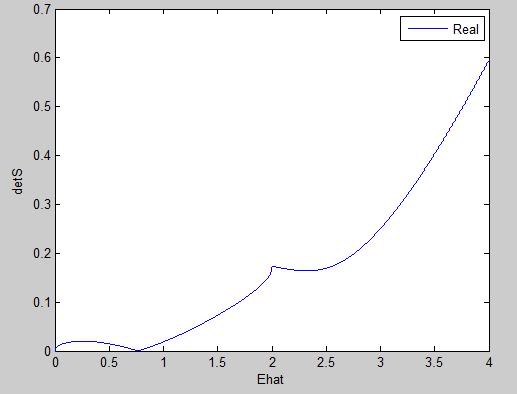

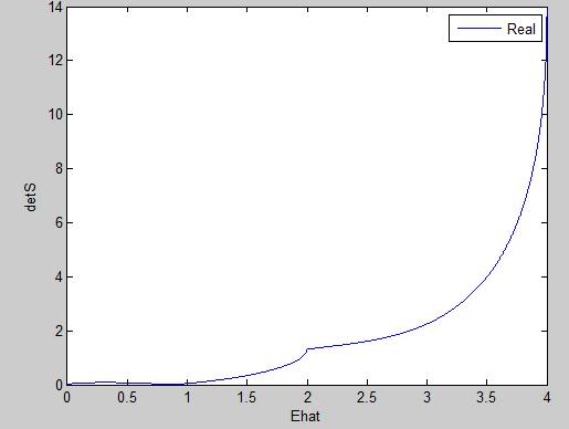

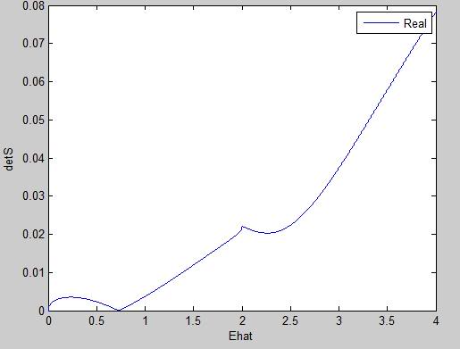

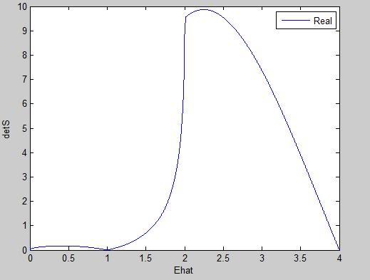

I wrote a whole heap of MATLAB code, and I have no idea whether my answers, or the plots of my answers are anywhere in the vicinity of looking right. I was hoping someone with a lil bit of experience in this type of physics would be able to tell me if I'm on the right track..
None.
for \alpha = 1
for \alpha = 2
for \alpha = 5
for \alpha = 10

What do the x-axis and y-axis represent?
the x-axis is Ehat - the energy, normalised. So: Ehat = E \frac{L}{2}, where L is the length of gap in my "well"
and the y-axis is detS - the determinant of the matrix I created from the boundary and interface conditions. So each x-axis crossing should give me an energy eigenvalue shouldn't it?
if so, why am I only getting one zero-crossing in each graph?

I think your plots are alright. The only thing to note is that in your first plot \alpha = 1, it appears that there are two crossings. If you reduce your scale, I think there's a chance that the line at 4 approaches the x-axis closely,but doesn't actually touch it.
This would explain why that there's only one crossing for the other alphas.
