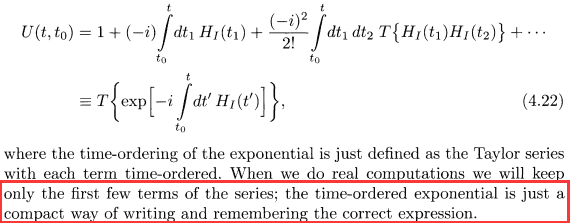

In Peskin's QFT textbook, according to the explanation below(4.22), the Time-ordered exponential is just a notation, however in the derivation of (4.31),the Time-ordered exponential seems more than just a notation.
In Peskin P85:
It says the Time-ordered exponential is just a notation,in my understanding, it means
$$\begin{aligned}
&T\left\{ \exp \left[ -i\int_{t_0}^t{d}t^{\prime}H_I\left( t^{\prime} \right) \right] \right\}\\
&\ne T\left\{ 1+(-i)\int_{t_0}^t{d}t_1H_I\left( t_1 \right) +\frac{(-i)^2}{2!}\int_{t_0}^t{d}t_1dt_2H_I\left( t_1 \right) H_I\left( t_2 \right) +\cdots \right\}\\
\end{aligned}$$
However in the derivation of (4.31):

What's more, in the derivation of (4.44):
In order to apply wick's theorm, Time-ordering must go inside the integral.
So my question is:
Does Time-ordering and Time Integral commute?
Or in another word:
Can Time-ordering can go inside the integral?
I have found a great answer:
Prahar (https://physics.stackexchange.com/users/8821/prahar), Time ordering of integral, URL (version: 2022-12-17): https://physics.stackexchange.com/q/741494
$$T\int_{t_0}^t{d}t_1\cdots dt_nH_I\left( t_1 \right) \cdots H_I\left( t_n \right)$$
is defined to equal to
$$\int_{t_0}^t{d}t_1\cdots dt_nT\left\{ H_I\left( t_1 \right) \cdots H_I\left( t_n \right) \right\}$$
Otherwise the left side does mean anything.
This definition can be extended to cases like##T\left\{ \phi \left( t\prime_1 \right) \cdots \phi \left( t\prime_m \right) \int_{t_0}^t{d}t_1\cdots dt_n\phi \left( t_1 \right) \cdots \phi \left( t_n \right) \right\} ##
$$\begin{aligned}
T\left\{ \phi \left( t\prime_1 \right) \cdots \phi \left( t\prime_m \right) \int_{t_0}^t{d}t_1\cdots dt_n\phi \left( t_1 \right) \cdots \phi \left( t_n \right) \right\} :&=T\left\{ \phi \left( t\prime_1 \right) \cdots \phi \left( t\prime_m \right) \int_{t_0}^t{d}t_1\cdots dt_nT\left\{ \phi \left( t_1 \right) \cdots \phi \left( t_n \right) \right\} \right\}\\
&=\int_{t_0}^t{d}t_1\cdots dt_nT\left\{ \phi \left( t\prime_1 \right) \cdots \phi \left( t\prime_m \right) \phi \left( t_1 \right) \cdots \phi \left( t_n \right) \right\}\\
\end{aligned}$$
Likes vanhees71
Yes, they commute and it can go inside the integral. Your first inequality should be the equality.
Likes vanhees71
I think it's a definition of the time-ordering symbol to apply it to the integrand, i.e., to commute it with the integral. It's defined to get a compact notation of the Dyson series of time-dependent perturbation theory in terms of a "time-ordered exponential". If you look at the derivation of this formula, that'll become clear. See, e.g., Sect. 1.9, where it's derived for potential scattering in non-relativistic QM:
https://itp.uni-frankfurt.de/~hees/publ/lect.pdf
Likes George Wu
