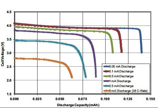

The capacity of a battery depends on how fast you draw power from it. The ma-hours measurement is a a certain current draw. If you draw current at a higher rate, then you not only get less hours, but the ma-hours available also decrease because of battery chemistry issues.

There is a "sophie-bomb" lurking in any home-built (and some commercial) Li-ion battery charger, especially if not using a controller IC. It is a tricky technology.But, to answer the original post again,
Given a commercial battery operated USB charger, the amount of charge (capacity) is affected significantly by the current draw, as the curves show for lithium ion. There are similar curves for NiMH, nicad, and alkaline batteries.
The following curves are for alkaline primary (non rechargable) cells.
http://www.powerstream.com/AA-tests.htm

I think we have wandered far afield. The OP was asking about the characteristic of batteries to produce less ampere-hours when discharged at higher currents and whether that was true.
It IS true, and is caused by battery chemistry. We have yet to hear from him again. He showed no inclination to build a charger or mess with charging batteries.
