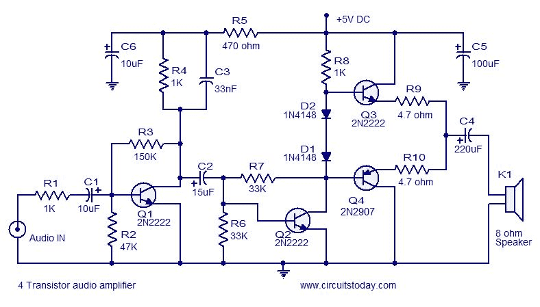

Does C3 have to be a electrolytic cap?

Not that I can see. Sometimes folks use that same capacitor symbol for unpolarized caps, which I dislike. You should be able to use a ceramic cap there instead.

Do you understand why the polarities of the electrolytic caps in this circuit are the way they are? How would you determine what the polarity of the voltage is across those component locations where you use an electrolytic cap? The power supply cap is obvious, but what about the ones in series with the AC signal? :smile:
Give me a min. to look
The curved line on the cap symbol is positive.
All of the caps, C1 through C5 connect their positive side to the +5 Volt rail.
Also C1 is connected to the base of the 2222 which is positive and so is the collector.
C1 is preventing DC from going back to the input I assume.
Am I missing anything??
no, the curved side is the negative side
Note the polarised caps ( electrolytics) are marked with a +
the ones that are not marked with a + ARE NOT polarised :smile:
I also echo Berkeman's comments ... that old style cap marking is a pain and a trap for young players
yes, but can you see what is making the base side of the transistor and C1 more positive than the other (left ) side of C1 ?
yes ... primary purposes are interstage AC (signal) coupling and DC blocking, as is C2. C4 is DC blocking as we don't want a DC offset voltage appearing across a speaker

you could, but a bit of basic circuit analysis will tell you what points/nodes are more positive than others.

Hi Dave...sorry..yes of course I had it backwards on the caps as is easy to see on the schematic.
C1 is more positive because of R2...I think
partly, as R2 does lift that node above the 0V rail, but that isn't the main reason, look higher up
There is a 1K resistor between the rail and the collector and a 150K plus the 1K between the rail and the cap.
Are the two diodes used to prevent damage from hooking up the power backwards? They also produce a voltage drop of around 1.4 v at the collector of Q4 I assume.
Yes ... so overall, what process are the resistor pair R2 and R3 and the single resistor R4 doing ?
Controlling current through Q1.

the single resistor R4 is doing that as well as a voltage dropper
but look at the configuration of R2 and R3 ... do you recognise that config ?
No, I don't recognise the config but I assume the following.
We need to get AC to the base of Q1 and R2 and R3 makes it go there.
We need DC to get to the base of Q1 and C1 ,R2, and R3 makes it go there.

OK, no prob ... .it's called a voltage divider ... sound familiar ?
put 2 resistors between + and minus of a supply source and the voltage at the centre node is proportional to the value of the 2 resistors
no, they don't help achieve that, only C1 passes the incoming AC signal to Q1
Yes, but for a very specific purpose
As said R2 and R3 create a voltage divider with the base of Q1 being at the centre node
This biases the transistor on and keeps it within its linear range to help avoid distortion of the signal
You also need to consider that the AC voltage at the node of C1 and Q1 base may not be high enough at
times in its cycle to allow Q1's base to emitter path to go into conduction ... providing that bias voltage overcomes that problem

Ok...so a NPN transistors need a certain positive voltage at it's base to conduct. Correct? What would be a nominal voltage?
for a standard silicon diode or transistor it is approx. 0.7 V ( + - 0.05V )

Planobilly said:
Just to be clear, is it the voltage or the current that keeps the base to collector open?
once the voltage across the PN (B-E) junction reaches 0.7 V or higher, current will flow.
A side note, you don't want that voltage to go too high else the transistor goes into saturation and causes other problems
I won't go into the fine details as I'm not a semiconductor expert LOL
now you may see why in a AC - DC rectifier circuit, we loose 0.7V for each of the diodes that are in conduction mode
So the first 0.7V is lost and for a full wave rectifier dual diodes or a bridge we have a total of 1.4V lost from the final DC output voltage

One other question is what is the purpose of R1 and how would one go about changing the input impedance.
R1 sets the input impedance so the input impedance in this case is around 1k ... pretty common value for a line level input

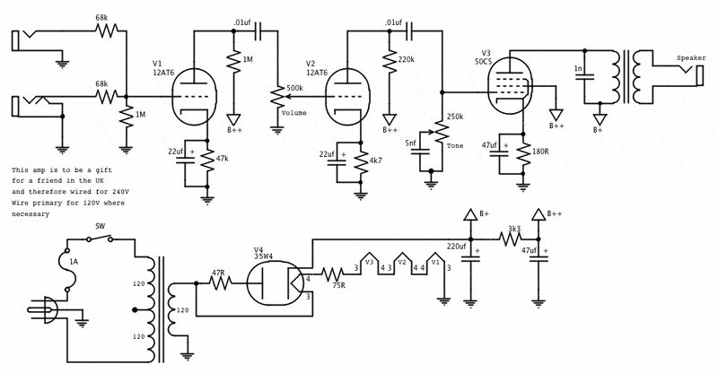

I assumed that R1 controlled the impedance. So if I wanted to input a guitar signal is there any reason I could not use a 1Meg resistor in this transistor circuit? I normally see the 1M resistor go to ground in a guitar amp..something like this.
Haven't played with tubes for years ... used to restore old valve radios in another lifetime and another country
from memory the grid inputs are pretty high impedance, so some impedance matching is called for between the input and the grid
or from one stage to another within the amp ... eg also look at the high values between V1 and V2
not sure offhand what the output impedance of a guitar is ... do a google for both of us and see what you find :wink:
bi-polar transistors, on the other hand, are much lower impedance ( FETs are high impedance and are treated more like tubes)
Dave
Pickup impedance for guitars is around 6K to 17K. Normal input impedance for tube guitar amps is somewhere around 1M.
I also assume going from the guitar to the input to a 12AX7 pre amp tube for example one would be concerned about getting as much voltage as possible. I also assume that a big mismatch like 17K to 1M would have that effect. Having said that I don't know how to prove it.
I assume about 1000 ohms output impedance for a CD player
OK so the 68k and the 1M will be doing some impedance matching between the ~ 10k to the several M Ohms of the grid
