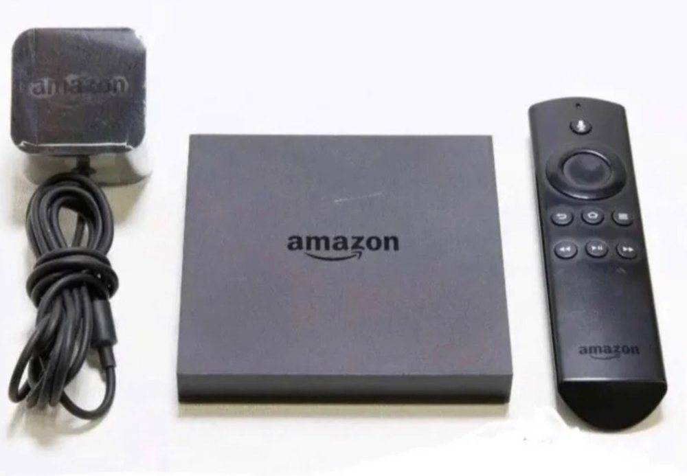

leaving an old wifi device in my fridge a few hours fixed it.
This is more of a consumer question from someone who knows nothing about electronics: Last night my old Amazon Fire TV device apparently died, but after leaving it in the fridge all day it's now working again. What happened?
Semiconductor leakage currents increase with age and with temperature. Cooling the device may reduce leakage currents.
Warning: If you put electronics into a refrigerator, condensation of water onto the circuit board may cause problems due to leakage. Breakdown of high voltage supplies is likely.

Do you mean within the device or outside of it, in my house? I don't mind risking the device since it's obviously on its last legs anyway.
Internal to the device.
If the device is poorly vented and contains warm humid air, then refrigerating it will condense some of that water internally as it cools.
If it is open and well vented then when the cold device is returned to a warmer high humidity environment it may condense water on internal cold surfaces.

The device isn't in an especially hot place, but strangely it seems to have no ventilation holes at all. In the past when it's stopped working I've unplugged it for a few days, then it worked fine after plugging it back in. That didn't work this time but, other than cooling off, I couldn't think of anything that would be happening during those unplugged days, so I tried the refrigerator. I wrapped it in a paper napkin and plastic before putting it in the fridge to keep out moisture, but yes I imagine there's internal moisture trapped inside it, too.
I ordered a new one because I expect that this will only be a temporary fix. I didn't realize that electronics "wear out" like mechanical parts do.
I think they're no longer made, instead Amazon has the "stick" which hopefully works as well.

I would not stick that into the television after putting it in the fridge.
I think viewing the stick on its last legs and taking the risks is okay, but sticking it into a known good television... you're risking the television too. Best case scenario if it damages the television is only the port is broken, but I've seen during my years a technician... broken ports damaging the entire device (this I did not have an engineering background at the time to understand it, but I am thinking in hindsight a short related to the power could be the cause). My guess is your Fire Stick is worth $40-50 USD ish... how about your television?
I'm not going to suggest that is happens every time, but it's unnecessarily higher risk than usual.
I think the damage is done and it is too late for your Fire Stick (due to the possible humidity that Baluncore is talking about), but maybe the next electronic consider using a fan instead. I've had laptops that get super hot and would not turn on anymore... lift the laptop with the screen against the table and a regular fan blowing against it's bottom for a few minutes (or more convenient since it's available for a laptop just a laptop cooling pad)... it might turn on and boot into its operating system long enough for me to gather whatever the customer was trying to recover. I believe the same concept would work for other electronics.
Thanks, Joshy. I wonder if blowing a fan on the ports (there are two or three on the back) could possibly blow out the moisture.
Moisture is usually condensed onto cold surfaces, or dissolved in the air as humidity. You must lower the relative humidity by raising the temperature of colder drier air. I use a warm hair drier to dry equipment.
The most significant danger of refrigeration comes from insulation breakdown within switching power supplies, where several hundred volts DC can damage the PCB insulation before the internal fuse blows. I see in the photo the device has an external switching supply. Keep that away from the refrigerator.
Refrigeration is a quite unnecessary risk when air cooling can achieve the same result.
