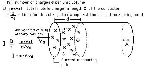

Would a Microscopic View of Electric current be more helpful?
I will defiately be more careful as to "current flow" in the future in terms of the model shown I assume this is the exact same for positive charge carriers? Not in a metal but I remember reading they do exist (Ice perhaps it was?).
