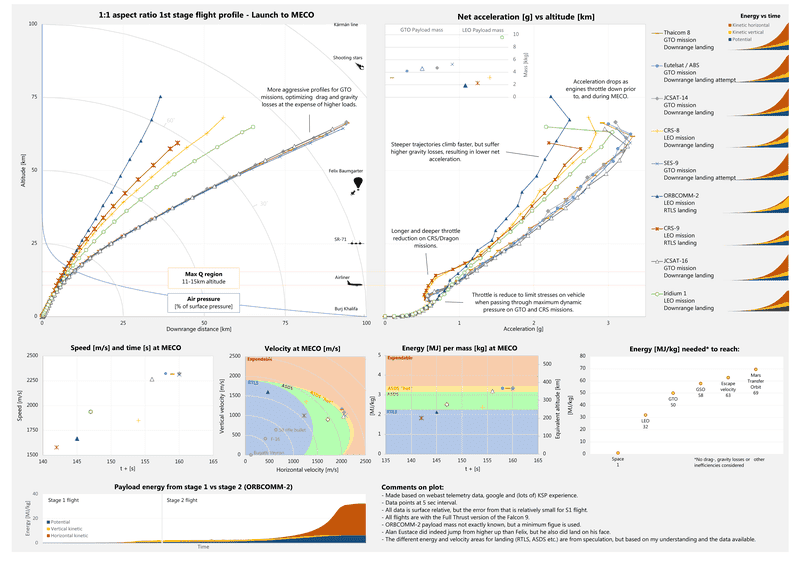

I found the following (old) plot someone posted on reddit that pertains to show the first stage profile and other instersting data for several Falcon 9 missions (it is nice because both the altitude and down range axis has same unit and scale):
