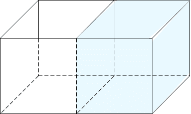

Let me transmogrificate your thought experiment to the following: we have a sturdy container with a sturdy barrier in the middle:
Fill the right half with water and put the whole thing on wheels so it can move freely left and right.
Suppose the whole thing is 1 x 1 x 2 m so the center of mass is at 0.5 m to the right of the barrier
What happens when the barrier is removed instantaneously ?
My guess is that if the sloshing has come to an end, the center of mass is still in the same place (no horizontal external forces have worked on the system). So the container has moved to the right over a distance of 0.5 m.
(If the sturdy walls and the barrier represent a considerable mass compared to the 1000 kg of water, some allowance has to be made and it will be a little less than 0.5 m)​
Would that be intrinsically different from your scenario ?
No looks like the same scenario to me
