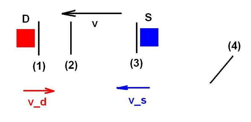

Hehe, you have ASSUMED that the velocities are constant :biggrin: Now an MCQ :biggrin: See the picture. The black lines denote wave fronts. Suppose that instance is at t=4s. Which wave front does D (detector) "capture" and read?
A. (1)
B. (2)
C. (3)
D. (4) ?!
At what time is that wave front emitted from S (source)? Is it at t=4s? Or earlier? Or later (?!)?
  • Diagram of a Doppler setup: a red detector D on the left and a blue source S on the right, with labelled black wavefronts (1) to (4), a leftward arrow labelled v, and red and blue velocity arrows labelled v_d and v_s.
The detector will capture 1 ,2 ,3 wavefronts one after the other.
It captures 1 first. It was emitted from the source at time less than 4s.
Is it right?

Yes, you're right :wink:
So basically what D receives is the wavefront that S emits earlier. To make it easier to understand, assume that S can emit 2 consecutive wavefronts while its speed is still nearly the same (then another couple of wavefronts when S jumps to another speed and so forth). So the distance between the 2 consecutive wavefronts is determined by the speed of S at the time of emission t1. This distance is simply the wavelength of the signal emitted by S at the time of emission t1. Then when D detects this signal, what D receives is the signal of wavelength (or frequency, by the relation lambda = c/f) corresponding to the time t1, while D is at the time t2 > t1!
In the case of constant speeds, since the speed of S doesn't change, there is no difference in the signal at time t1 or t2. Therefore even if you plug in the speed of S at time t2, it still gives you the right answer.
On the other hand, in this problem, the speeds of S at t1 and t2 are different, and so are the signals. Therefore you cannot plug in the speed of S at time t2; it should be the speed of S at time t1.

When is the wavefront that reaches the detector at t=4s emitted by the source? Certainly its not at t=0 but at some other time between 0 and 4s. This problem is spinning my head!
Abdul Quadeer said:
In this problem, we don't know what is the speed of source at time t1.
We don't know immediately, but we may know. Do some math :smile:
The initial distance between D and S is d. At time t1, S moves by a distance A = at12/2 and emits the wavefront that later meets D at t=4s. This wavefront moves with constant speed v = 300m/s. So by t=t2=4s, this wavefront moves by a distance B = v(t2-t1). Also at t=4s, D moves by a distance C = at22/2. We must have: d = A + B + C, as D meets the wavefront at t=4s. Now solve for t1 :smile:
