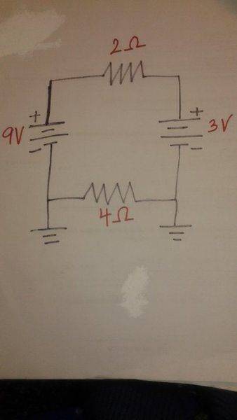

What is the current in the 2 ohms resistor?
Kirchhoff's loop law
Grounding does not affect how the circuit behaves, so I ignored the ground in and applied the loop law (clockwise from the negative terminal of the 9V battery ):
ΔV(loop) = 9V -(2 ohms)*I - 3V - (4 ohms)*I =0
6V = (6 ohms)*I
I = 1 A
Correct?
well i do not work with circuits much- but if you have grounded both terminals of a load -can you expect a current to flow in the lower 4 ohms resistance.
grounding a circuit defines the potential to be zero (definitely)
further i failed to understand -what you wish to convey through this expt.?
Incorrect. The system is grounded at two different points, indicating that those points must have the same potential.
^^...So you have the same simplification as in the last problem. After which...? :oldsmile:
So I can ignore the 4 ohms resistor in my calculations? Then the current through the 2 ohms resistor would be given by:
9V - (2 ohms)*I - 3V =0
6V / 2 ohms = I = 3A
From what I understand now, the 4 ohms resistor might as well not be there...it's between 2 points of zero potential and so no current flows through it. Right?
Right. You need a potential difference between its ends to provide a current.
In this respect, grounding the two points is like short-circuiting them.
This is correct.

I'm getting better at this circuit analysis thing!
kamhogo said:
View attachment 98526 I'm getting better at this circuit analysis thing!
etc.That seems correct.
The image is hard to read. I had to zoom way in.
In the future it's best to start a new tread for a new problem.
