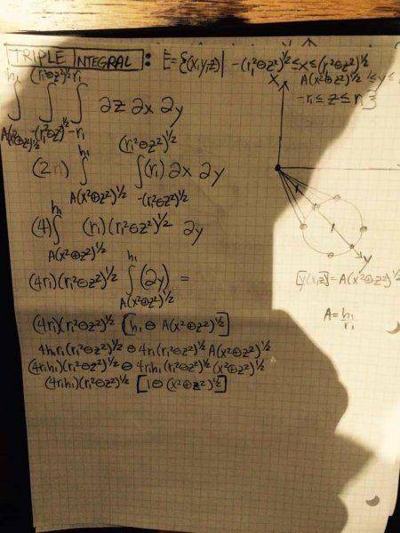

PaultheRiemann
This is the equation for the cone
A \sqrt{x^2 + y^2}
The double integral
\iint A \sqrt{x^2 + y^2} \space dy \space dx \space \space \space\text {From x= -1 to 1 and y=} -\sqrt{1-x^2} \space to \space \sqrt{1-x^2}
\text{ is very difficult to evaluate. I've tried polar coordinate substitution. However, I can't seem to get} /space 2/3 \pi z \space \text{where z is the height of cone and 1 is the radius of the cone}
\text{here's what happens when I use CLAIRAUT theorem to change the order of the pertaining triple integral}
Handwritten triple integral derivation on grid paper: outer integral from r1 to h1, inner integrals over A(x^2+y^2+z^2)^(1/2) with 2π and 4π factors, ending in a boxed expression. A small sketched circle with radial lines is shown on the right.
I'm also trying my best not to use cylindrical and spherical coordinate systems.
You are not getting any responses, perhaps because no one can understand what you are saying.
Put your Latex between double dollar signs.
$$A \sqrt{x^2 + y^2}$$
No, it isn't, in fact, it is not even an equation! I assume you meant $$z= A\sqrt{x^2+ y^2}$$ but even that is only one side of the cone- the entire cone is $$z^2= A^2(x^2+ y^2)$$
The double integral
$$\iint A \sqrt{x^2 + y^2} \space dy \space dx \space \space \space$$$$\text {From x= -1 to 1 and y=} -\sqrt{1-x^2} \space to \space \sqrt{1-x^2}$$
To integrate $\int_{x= -1}^1\int_{y= {-\sqrt{1- x^2}}^\sqrt{1- x^2} A\sqrt{x^2+ y^2}dy dx$$
I would first use trig identity $$tan^2(\theta)+ 1= sec^2(\theta)$$ and make the substitution $$y= xtan(\theta)$$. Then $$\sqrt{x^2+ y^2}= \sqrt{x^2+ x^2 tan(\theta)}= x sec(\theta)$$. Also $$dy= sec^2(\theta)d\theta$$

No, it is not that difficult. The substitution $$y= x tan(\theta)$$ works nicely.
But I don't see why you are doing that. if you want to find the volume of a cone, with height h, then the double integral you are using isn't going to do it. Instead, note that, for any z, a cross section is a disk with center (0, 0, z) and radius $$r= \sqrt{x^2+ y^2}= \frac{z}{A}$$ so area $$\pi \frac{z^2}{A^2}$$. Taking the "thickness" to be dz, the volume of such disk is $$\pi \frac{z^2}{A^2}dz$$. The entire cone, thought of as the sum of such disks is $$\frac{\pi}{A^2}\int_0^h z^2 dz$$. In this particular cone, with $$z= A\sqrt{x^2+ y^2}$$ a cone with height h will have base radius $$\frac{h}{A}$$.
That will NOT give "$$\frac{2}{3}\pi h$$" because that is NOT the formula for volume of a cone. The volume of a cone, of height h and base radius R, is $$\frac{1}{3}\pi r^2h$$- 1/3, not 2/3.
