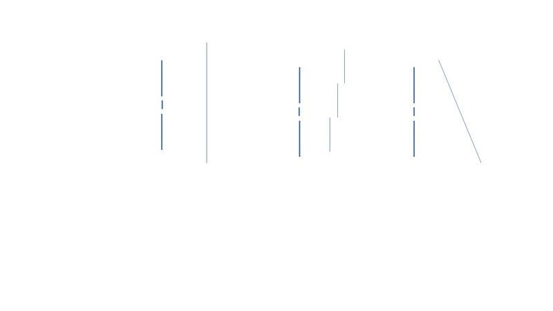

I have a further question - Has there been a double slit experiment where instead of letting the pattern emerge at one barrier, there are several smaller barriers at difference distances and what if any was the pattern which emerged? Is it still consistent with the wave interference pattern or not (as say something like the image attached)?
Diagram of several vertical blue barrier lines with gaps at different positions, with a thin grey vertical line and a diagonal line on the right, on a white background.

vanhees71 said:
Another point is that you don't need decoherence to destroy the interference pattern in the double-slit experiment by gaining which-way information. It's sufficient to somehow mark each photon such that you can determine with certainty through which slit it came.
A very simple setup of this kind is to work with single polarized photons incident on the double slit. Say they are horizontally polarized (in ##x## direction). If you now just set up the double slit, you'll see a double-slit interference pattern after repeating a many times with such prepared photons.
Now to mark each photon going through the double slit, put two quarter-wave plates into the slits. Orient one at ##45^\circ## and one at ##-45^\circ## relative to the ##x## axis. A H-polarized photon going through a ##45^\circ## oriented quarter-wave plate will be left-circular polarized, and if it's going through a ##-45^\circ## oriented quarter-wave plate it will be right-circular polarized. That means that the photons behind the slit are marked such that you can with certainty say through which slit it came, i.e., if it's left-circular polarized it went through slit 1, if it's right-circular polarized it went through slit 2, i.e., it carries certain "which-way information", and then the quantum theory tells you that there'll be no double-slit interference pattern when repeating the experiment with many photons left anymore. It's just an incoherent superposition of the single-slit patterns.
It is sufficient that each photon's way is "marked" by its polarization. It's not necessary to really take note of which polarization it has, i.e., which way it took, to destroy the double-slit interference pattern. It's sufficient to somehow make it possible to do so.
It’s been done. It’s part of almost every experiment, because setting up the experiment involves placing the detectors somewhere - and wherever we put them we have to calculate the expected results at that position.
