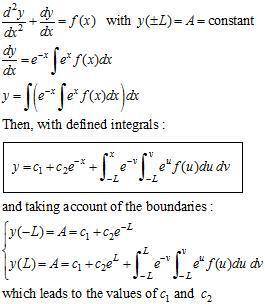

Hi Jollage !
I suppose that A is a constant and f is a known function.
Note : it should be [itex]\frac{\partial ^2 y}{\partial x^2}[/itex]
I am surprised that you introduces partial derivative symbols because there is only one variable in the equation. If your wording is correct, it is not a PDE, but an ODE.
This linear ODE can be analytically solved (attachment)

Sorry, I should write that correctly. I am thinking Navier-Stokes equation when I wrote these equation.. The example I showed is not what I want to solve, I want to discuss the boundary condition for the D term. Do you have a clue? Thanks.

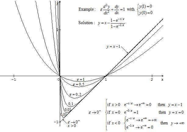

Hi !
The concrete example below intends to explain what happens. The example is chosen so that the ODE can be analytically solved and so that the solution be as simple as possible. This is shown on the attached page.
When epsilon tends to 0, the solution of the second order ODE tends to the solution of the first order ODE on the range where one boundary is located. The second boundary condition (which is not compatible to the solution of the first order ODE) introduces a discontinuity, i.e., at the limit for epsilon=0 the solution of the second order ODE is no longer a simple function but a piecewise function.
Nevertheless, you are allowed to give more than one boundary condition in case of a first order ODE, but this will leads to piecewise functions which are compatible with the ODE only on each intervals related to one of the boundary conditions.
Since you are from numerics, you are used to solve the ODEs thanks to numerical methods. Try several examples similar to the example given here. This will help you a lot to intuitively understand this kind of behaviour.
