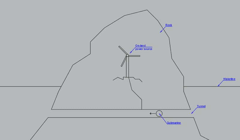

Hi everyone
I was reading about drag, and didn't quite find what I was looking for.
A general drag equation is : 0,5 x ρ x u² x Cd x A, where there are some drag coefficients that have been found during laboratory experiments.
Let's say a sphere with a radius of 1m is traveling at 2m/s under water, with buoyancy and gravity being equal.
0,5 x 1000 x 2² x 0,47 x π x 1² = 3kN
Not much, but at the same time speed is low.
But I guess that this equation has it's limitations: a free body of water with no restrictions?
What if this sphere were to travel trough a tunnel or pipe? A train going trough a tunnel at 200km/h there are a lot of factors of friction, and the size of the tunnel being a big part of it (as well as aerodynamic shape of the train).
If the underwater-tunnel is to small, even at slow speed, the sphere would be pushing the water in stead of going trough. But is it enough if the free area around the sphere is as big as the sphere, or are there other rule of thumbs here?

So, Max, what is the purpose of the tunnel ?
The purpose of the tunnel is (hypothetical) to use it as a transportation system, either as an attraction or an alternative means of getting from A to B through a solid mass without having to leave the water.
It could be done in a single person submarine (sphere like form) og a multiple person submarine (more of a bullet shape). It would be pulled along the way by a pulley system, and the question is how much force is needed to move said submarine at a speed of (let's say..) 2m/s.
Well, we do have the drag equation 0,5 x ρ x u² x Cd x A, but this isn't open water. In a restricted area in a tube (tunnel) the distance from the sphere to the walls will give a increased drag force due to the wall effect. I have only managed to find equations for low Reynolds number (in laminar flow) and not for high Re (turbulent flow).
The case being that I am only trying to find "ballpark numbers". And I was hoping for an equation in relations with sphere width / tube width. The distance from the sphere to the walls will need to be in the lines of 0,5m to 1,0m at least to make rom for pulley system and so on.

Still don't understand the need for a tunnel. If the pulley system is in place, what more do you need ? Unless this is about a transport system on dry land -- but then: why bring in the water ? A vacuum would be much more sensible !
The under-water-tunnel would be there to not need to convert the watercraft to a land craft and then back to a water craft. And in stead of use the one-board propulsion-system to drive it through the tunnel, the one-board system could power down to save energy and in stead be pulled trough the tunnel on a system that is permanently installed in the infrastructure (tunnel). Further I would assume a propeller of some sort on this sub would contribute to the drag force from the turbulence (?). Figure:
When going over or around is a unwanted situation.
So the drag force in the sphere will determine what is needed to pull this along.
