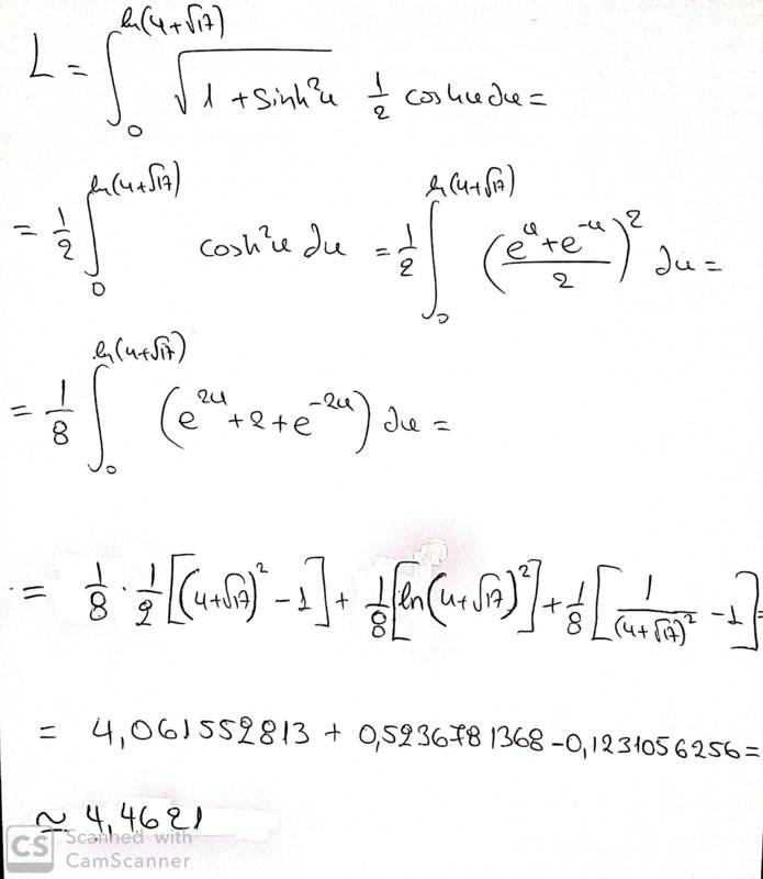

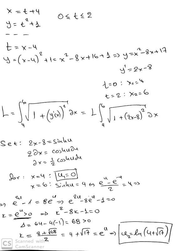

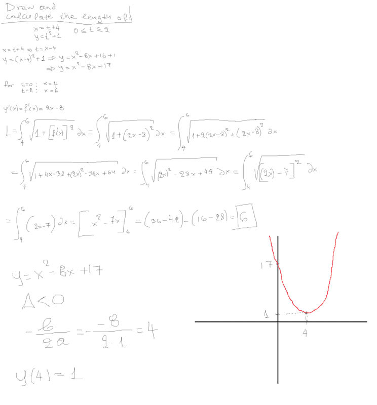

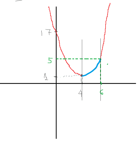

Hi,
my try:
Do you agree with me?
Thanks
Edit:
Michael_0039 said:
Homework Statement: Draw and find the Length of x=t+4 , y=t2+1
Homework Equations: nil
Hi,
my try:
Thanks
I don't agree. By going round in circles long enough, you finally got:
##2(x-8)^2+1 = (2x-7)^2##
Which can't be correct.
PS note that an alternative approach was to use the parameterisation you were given:
##ds^2 = dx^2 + dy^2 = (\frac{dx}{dt}dt)^2 + (\frac{dy}{dt}dt)^2##
Hence:
##ds = \sqrt{(\frac{dx}{dt})^2 + (\frac{dy}{dt})^2} \ dt##
