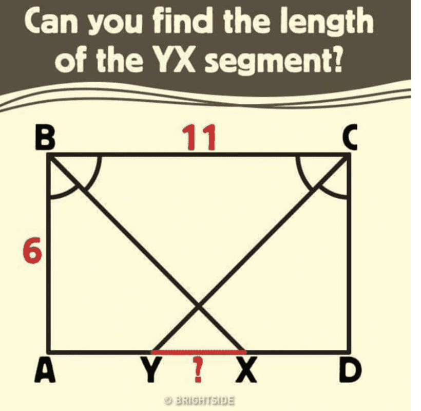

Find the length ##XY## by considering the given diagram
cosine rule, similarity, pythagoras theorem
Rectangle ABCD with AB = 6 and BC = 11, diagonals from B to X and from C to Y crossing inside it; the segment YX on side AD is marked in red with a question mark.

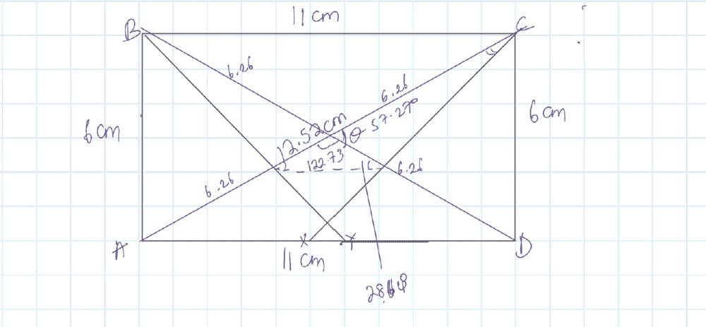

i saw this question on the internet. The people responding were of the opinion that the length##xy=1##, but no working...first of all is the answer ##1## correct?
i am trying to find the steps to solution, i have managed to find an angle ##57.27^0## by cosine rule, i tend to think that i need to sort of find the angles then calculate the length. My other thinking is to use similarity. Am still trying to work on it. cheers
my working,
Handwritten geometry sketch of rectangle ABCD with diagonals meeting at O, sides 11 cm and 6 cm, labelled values 6.26, 12.52 cm, 57.27 degrees, 122.73, 28.68 and point X on side AD.
chwala said:
Homework Statement:: Find the length ##XY## by considering the given diagram
Relevant Equations:: cosine rule, similarity, pythagoras theorem
my working,
Is it given that the figure is a rectangle?
Yes it is, ...##11## by ##6##

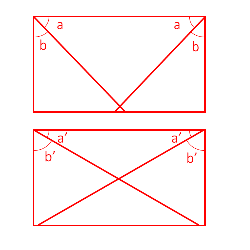

Is it a given that angle ABX and angle CBX are the same?
If not, I don't see how this is solvable, since these would both be perfectly valid solutions:
Two red rectangles, each with two diagonal lines meeting the bottom edge or crossing; top shows lines meeting at a point on the bottom edge with angles labelled a and b at the top corners, bottom shows crossing diagonals with angles labelled a' and b'.
[ EDIT ] Just checked the convention:
Three rays fanning out from a common point at the bottom left, with the angles between the first and second rays labelled A and between the second and third labelled B.
OK, so ABX and angle CBX (and their mirrors) are equal.
If not, I don't see how this is solvable, since these would both be perfectly valid solutions:View attachment 277691

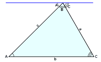

That's not how it was when I learned geometry. Two equal angles were marked with an arc and a tick mark through the arc. Two other equal angles were marked with two tick marks. Pairs of angles with the same number of tick marks are assumed to be given as equal.
If angles ABX XBC, BCY, and YCD are all congruent (equal), the problem is trivial. The Sine Law and Cosine Law are completely unnecessary.
If you have a rectangle, what are the corner angles? Now divide that into two equal angles. Now ABX is a right triangle with one side known and the other angles known. You should be able to figure it out from there with practically no calculations.
This really looks to me that the length is a function of the two angles ##\angle## BCD=##\theta## and ##\angle## BCA= ##\alpha## so that the length is a function##f(\theta,\alpha)## since we have no information in the diagram, even though they look the same, that they are.
My suggestion then is to just work it out with a few real angles then generalize it to ##f##
Yes, but another convention (sans ticks) is:
Triangle with vertices labelled A, B and C, sides labelled a, b and c, a horizontal line above vertex A, and angle arcs marked at the top and bottom vertices.
(as shown in post 4)
My training was that identical markings on angles indicated that they were equal. I have seen different symbology used by different people. Furthermore, assuming that the marks on the angles indicate something, I must assume that they indicate equal angles. Otherwise, there is no answer to the problem.

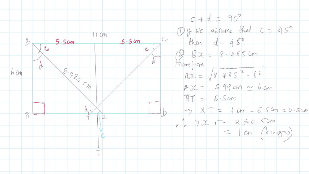

It's much simpler than that, assuming that all of the corner angles are equal (and equal to 45°), and that the figure is a rectangle. Given those assumptions, you don't need any of the calculations in the image you attached.
AB = 6, so Ax = 6 as well (isosceles right triangle). CD = 6 and Dy = 6 for the same reason. Since AD = 11, there's an overlap of 1, which is the length of segment XY.
chwala said:
i think i nailed it...bingo
Can't argue with success [edit: sure you can]. How did you get the value for the hypotenuse ?
hmmm27 said:
Can't argue with success. How did you get the value for the hypotenuse ?
Square root of ## 5.5^2 + 6^2##
Exactly. That's the hint I gave him in post #11
Mark44 said:
Why? The hypotenuse isn't needed.
I appreciate your approach ...its good but I think my approach would be better for students who may want to find value of the length segment ##YX## by way of calculations...cheers
