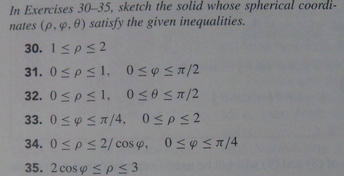

I had a tutorial today and my tutor said these questions are very trivial so we can simply look at it at home.
But after going home, I found that I don't know how to do Q 35.
I know that p<3 is responsible for the big sphere with r=3. But I don't know why the other part is responsible for the small sphere
Textbook exercises 30 to 35 listing spherical coordinate inequalities on rho, phi and theta, including 30: 1 ≤ rho ≤ 2 and 35: 2cos phi ≤ rho ≤ 3.

  • Textbook exercises 30 to 35 listing spherical coordinate inequalities on rho, phi and theta, such as 1 ≤ ρ ≤ 2 and 2cos φ ≤ ρ ≤ 3.

hi athrun200! :smile:
hint: draw a circle with B at the bottom, centre O, and any point P
then BP = 2OBcosOBP :wink:
