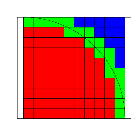

Perhaps this diagram will help. The red squares are the ones that are completely inside the disc. The untiled area inside the disc is less than the total area of the green squares. In fact it's equal to the total area of the parts of green squares inside the disc. Can you draw a smaller, concentric circle inside the existing one, such that all green squares are outside that new circle? Can you get a bound for how much smaller the new circle needs to be, and hence an upper bound on the untiled green area? Can you make that bound depend on ##k## so that it goes to zero as ##k\to\infty##?
  • Grid of dyadic squares in a quarter-disc: red squares fully inside the arc, green squares straddling the arc, and blue squares outside it, with the arc running from top-left to bottom-right.
If I start another circle at the bottom of the upmost green square, I would think that the green squares lie completely outside of this circle. Then the area between the inner circle and the outer circle is ##\displaystyle \pi - \pi(1- \frac{1}{2^{k-1}})^2##? Would this be an upper bound for the untiled area inside the disc?
I am not completely confident that it would not touch any green squares, particularly not one which the curve only cuts right near its top-right corner. It looks like it would probably work OK for this value of k, but we need the procedure to work for any value of k.
To be absolutely sure of not running into problems, calculate the greatest possible distance L(k) between any two points in a k-dyadic square, and draw the new circle with a radius that is L(k) less than the existing circle.
Then you'll be able to use a formula like the one you just wrote. It'll be a somewhat bigger annulus, but its area will still go to zero as ##k\to\infty##.

So is ##\displaystyle L(k) = \frac{1}{2^{2k-1}}##? I just got this from the Pythagorean theorem. So would the upper bound be ##\displaystyle \pi - \pi(1- \frac{1}{2^{2k-1}})^2##?
So does this argument show that we can tile the inside of the circle with finitely many dyadic squares so that we can get arbitrary close to ##\pi## given higher and higher values of ##k##? I just want to make sure I am understanding the argument right.

Well the greatest possible distance between two points on a dyadic square is the hypotenuse right? So that is ##\displaystyle \sqrt{(\frac{1}{2^k})^2 + (\frac{1}{2^k})^2} = \frac{\sqrt{2}}{2^k}##... Oh wait, with that thing I wrote before I forgot to take the square root of.
Yes, it's the absence of a square root that was worrying me. With that fixed, what you wrote should be fine.
