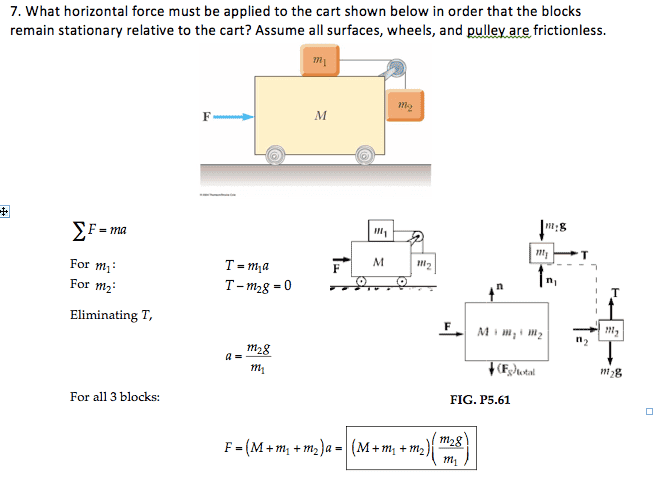

Please see picture.
Here is my method. Is it good?
T=m2g
m2g=m1a
a=m2g/m1
-n+Fpush=Ma. (n=normal force of m2 on M).
n=m2a=(m2)^2g/(m1a)
-n+Fpush=Ma.
Fpush=Ma+(m2)^2g/m

yolo123 said:
Please see picture.
T=m2g
m2g=m1a
a=m2g/m1
n=m2a=(m2)^2g/(m1a)
-n+Fpush=Ma.
Fpush=Ma+(m2)^2g/m
No.
There is a horizontal force of T exerted to the left on M via the pulley.
There is also a downward force of T exerted on M, but that doesn't come into play here. It would if there was friction opposing the movement of M.
Is the answer of the book wrong :O ?
Their result looks correct.

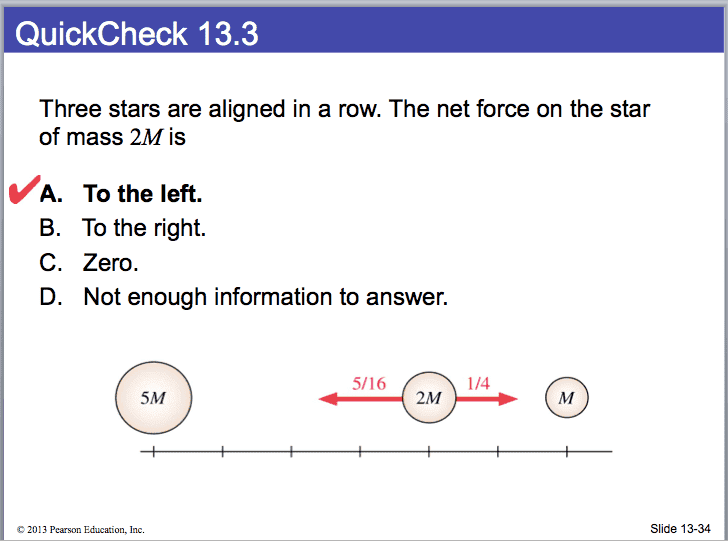

What about this problem? I solved the force values:
I get -(5/8)M^2G/r^2 for the first attraction of the big mass and M^2G/(2r^2) for the attraction of the small mass.
Where did they get 5/16 and 1/4?

yolo123 said:
Perfect, I will come back to it!
They merely used proportions.
Gravitational force is directly proportional to mass & inversely proportional to the square of distance.
Ok perfect!
Coming back to the previous question:
Would the equation for M be:
-T+Fpush-n=Ma?
Why is there a T? :O Is the pulley not frictionless?
yolo123 said:
Ok perfect!
-T+Fpush-n=Ma?
Yes, the equation is
-T+Fpush-n=Ma .​
Furthermore, T = m1a as well as m2 g .
Also, n = m2a .
Plugging those into -T+Fpush-n=Ma and solving for Fpush gives
Fpush = (M + m1 + m2)a​
in agreement with the book.
Yes, the pulley is frictionless, but there is thension T to the left on it an tension T downward on it. Both of these are transmitted to block M.
