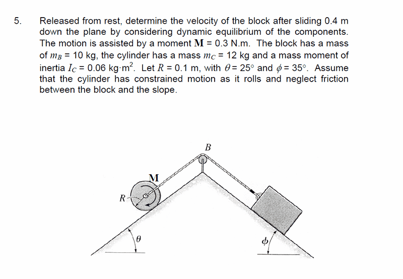

Dynamics Problem: Incline Block and Moment of Interia
The discussion centers on solving a dynamics problem involving an incline block and its moment of inertia. The participant applied the dynamic equilibrium equations, specifically ∑F=ma and ∑M=Iα, to determine the tension and subsequently the acceleration of the block. However, the participant failed to incorporate the provided moment of 0.3 Nm into their calculations, resulting in an incorrect velocity of the block. The correct answer is Vb= 0.5214 m/s at an angle of 325°.

3. The Attempt at a Solution
I used the dynamic equilibrium formulas to find the tension. The tension helps me to find the acceleration of the block. Then, I used kinematics to find the velocity. But, I'm not getting the right answer.correct answer: Vb= 0.5214 m/s 325°
I do not see that you used the given moment of 0.3 Nm.
