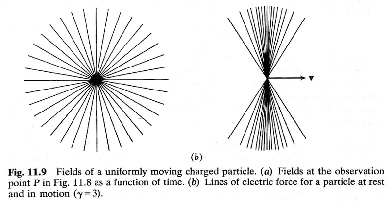

Then it is clearly wrong. You have field lines intersecting where there is no charged particle
What does your graph tell us that's not conveyed by the standard depiction of the electric field of a moving charge?
(from J.D. Jackson, Classical Electrodynamics, 2nd ed., pg. 555)

Those field lines are wrong - compare the diagram @renormalize provided in post #7. How did you calculate them? Your OP is very vague.
yeah, you got it right
