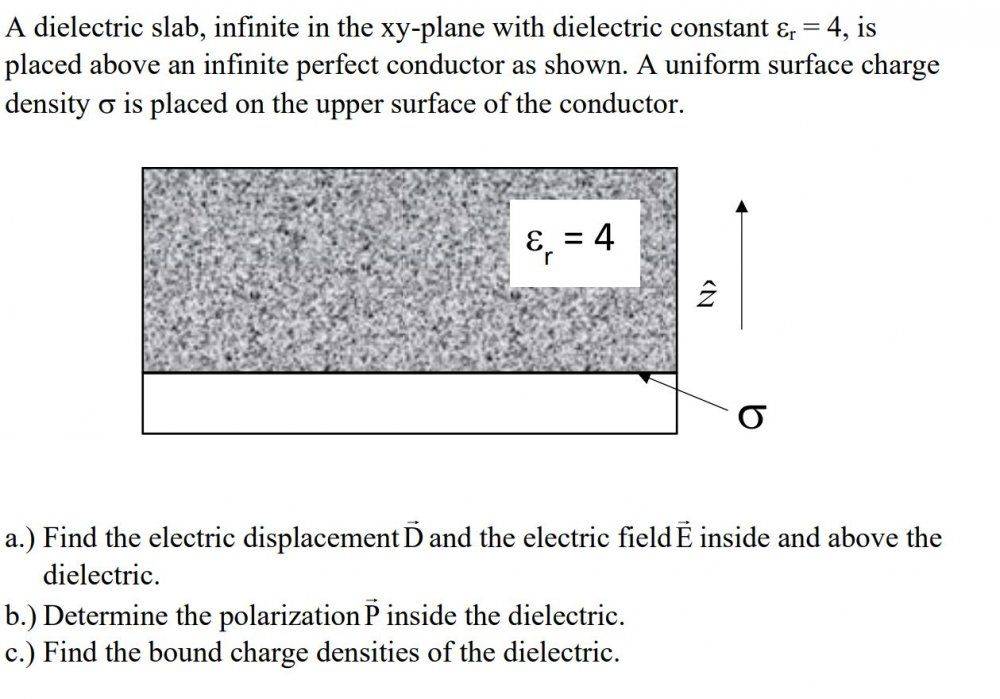

A dielectric slab, infinite in the xy-plane with dielectric constant epsilon r = 4, is
placed above an infinite perfect conductor as shown. A uniform surface charge
density sigma is placed on the upper surface of the conductor. (Picture in attached file)
a.) Find the electric displacement D and the electric field E inside and above the dielectric.
b.) Determine the polarization P inside the dielectric.
c.) Find the bound charge densities of the dielectric.
