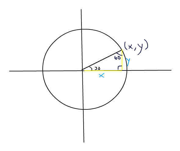

Another method that may help you should you forget is to draw a picture and use geometry/trig:
From my poorly drawn circle you can see you want to find the point, (x, y) on the unit circle that intersects with a line of the radial length drawn 30 degrees from the origin. The right triangle formed by hypotenuse (which is our radius of 1) forms a special 30, 60, 90 triangle. A property of such a triangle is that the hypotenuse is twice the length of the shorter leg, and the longer leg is ##\sqrt{3}## times the length of the shorter leg. Since the hypotenuse is one, the length of the shorter leg, ## y=\frac{1}{2}## and the longer leg, x is ##\sqrt{3}## times more so, ##x=\frac{\sqrt{3}}{2}##. So the ##sin(30)=\frac{1}{2}## while the ##cosine(30)=\frac{\sqrt{3}}{2}##
You can repeat the same logic for 60 degrees, or just realize that the x and y's are swapped. For a 45-45-90 triangle, the legs are congruent, so the hypotenuse is ##\sqrt{2}## the length of either leg. So let's say the hypotenuse has length ##x\sqrt{2}## in this case, since we know the length to be one, we can simply say ##x\sqrt{2}=1## or ##x=\frac{1}{\sqrt{2}}##. The legs are congruent so ##y=\frac{1}{\sqrt{2}}##.
For 15 and 75 degrees you can use ##sin(45-30)## and solve using trig rules. For 0 and 90 you can again draw a line from the origin to the corresponding point on the circle and see either, x=1 in the case of an angle of 0, or x=0 in the case of an angle of 90 or vice versus.
Not sure if this will help or not, hopefully it'll allow you to re-derive these values should you forget them on a test.
