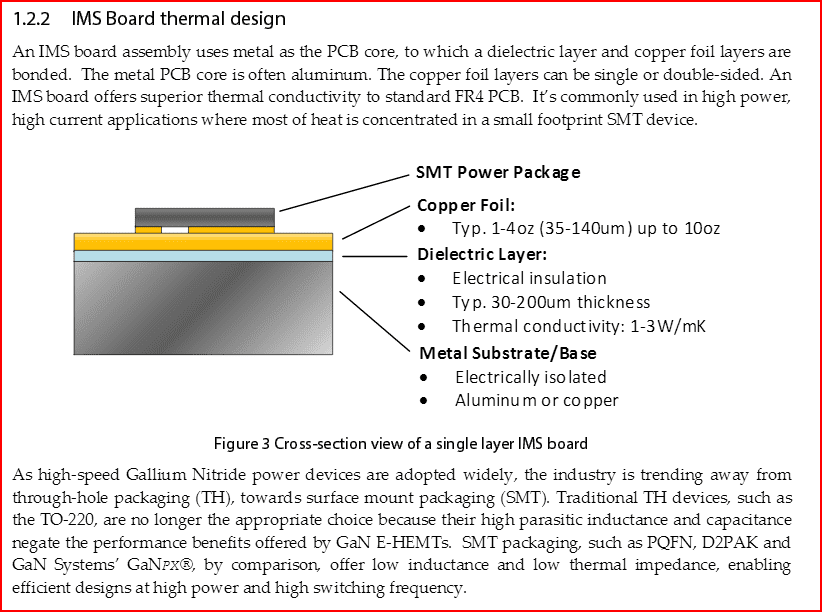

It is still about reference gathering, so I don't have much any of that. Cooling will depend on necessity: the switching element is preferred to be some type of SMD, with heat pad soldered to the PCB.
Maybe we can go with one of the reference designs
The plan is to do more or less the 'core' of this design, but on IMS.

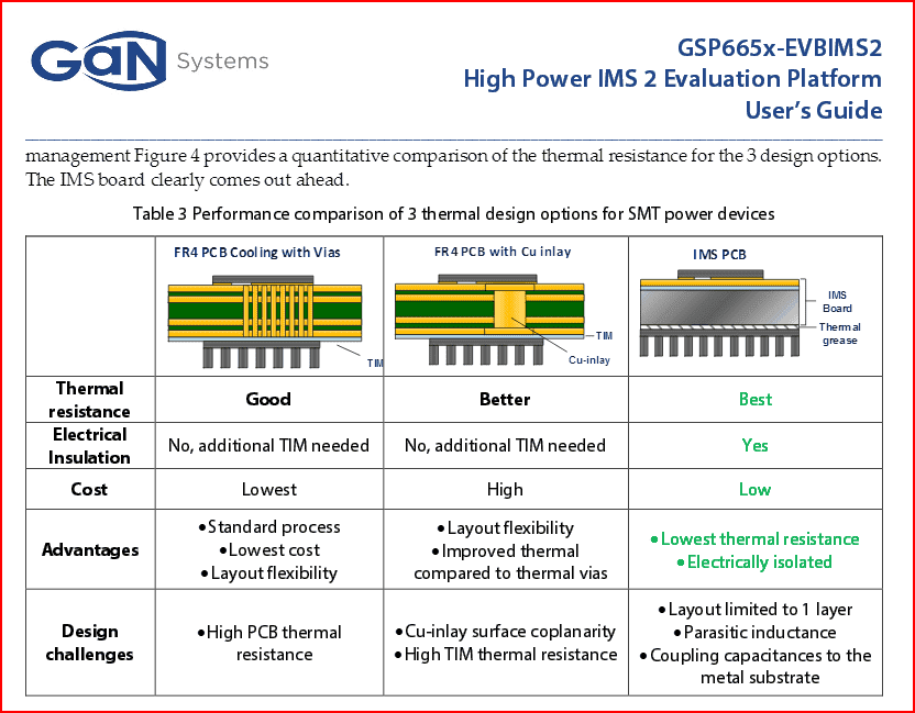

I could find designs with IMS (like the power board of this one or https://powerpulse.net/3-phase-1-25kw-200vac-gan-inverter-reference-design-for-integrated-drives/), but so far nothing with the gate driver on the same PCB: also nothing really specific the design of the gate driver on IMS.
Plane cutting - I will have no plane on IMS to cut. Needs to be single layer and I cannot cut the IMS itself.
Interesting. Do they mention eddy current issues in your links? So far I'm not seeing that...
From your 2nd link:
It's me who is worrying about that... And not finding references. Just like that document: parasitic inductance/capacitance is there, but (maybe because they have the driver on a separate PCB?) they did not mention anything about eddy currents/losses due the substrate.
