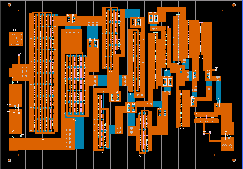

I’m facing strange phenomenon in voltage multiplier operation – PCB traces are overheating.
Multiplier runs at 50KHz, consumes 40V / 26A and delivers 500V / 2A.
The prototype is continuously monitored by IR camera due to overheating concern. None of electronic components is heating significantly. But very specific regions on PCB traces are overheating. It is not resistance problem - trace width and thickness is far above the requirement. In many places traces are very wide and still overheating.
I suspect that it is due to eddy currents running in circles on lateral plane of the trace.
Questions:
Is my assumption correct ?
Is there any other explanation ?
What can be done to minimize the phenomenon ?
To replace wide traces by bunch of narrow traces running in parallel ?
What about ground plane of PCB – is it beneficial or harmful in this context ?

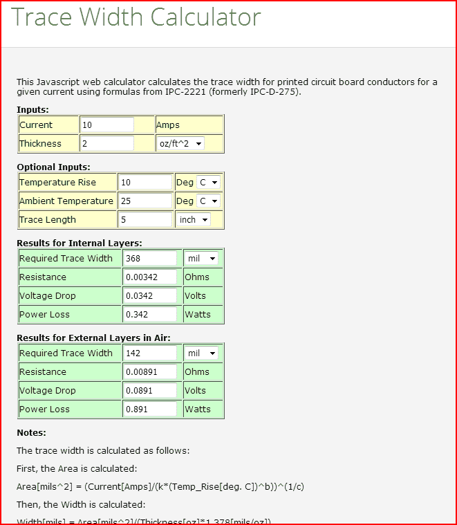

That's a lot of current for PCB traces. How wide are they, and how many ounces of copper are they (thickness)? Are they covered with soldermask? How long are the traces? Can you post a schematic, layout and an IR picture to show us which nets and traces are having the heating problem?

500 mil. Please note that specific trace which overheats is approximately in the middle of C-D chain and it bears only 6A

5 -10 cm. Actually it doesn't matter, because power dissipation is per length unit.
Hmm, that does seem to be wide enough:
https://www.4pcb.com/trace-width-calculator.html

In my experience designing power supplies for many years, the trace width calculators are terribly unreliable. For modern PCBAs it's not as much about the heat generation as it is about the heat removal. PCBs are terrible heat conductors, and convection cooling works much better for components (that rise above the PCB) than the traces. Of course for internal traces the situation is much worse; in that case you want lots of "thermal vias" to conduct the heat out of the middle.

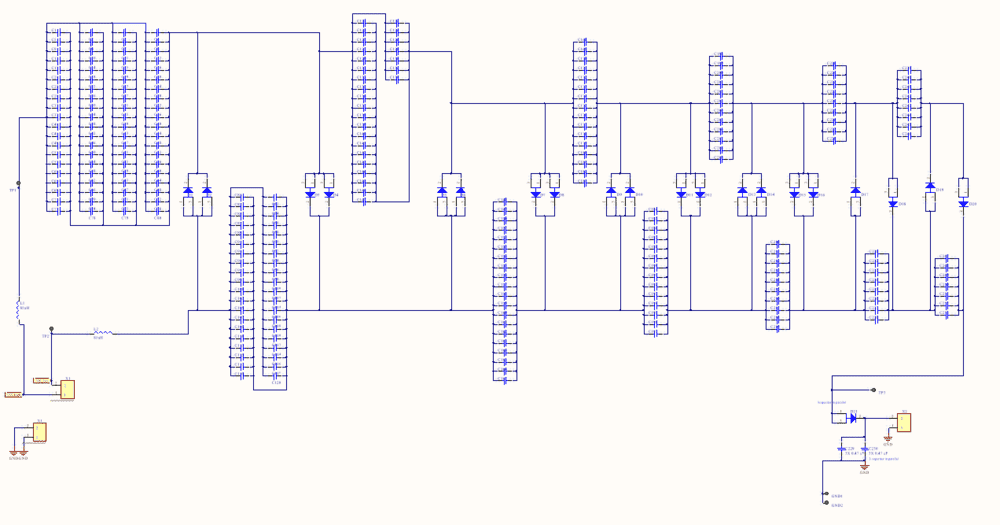

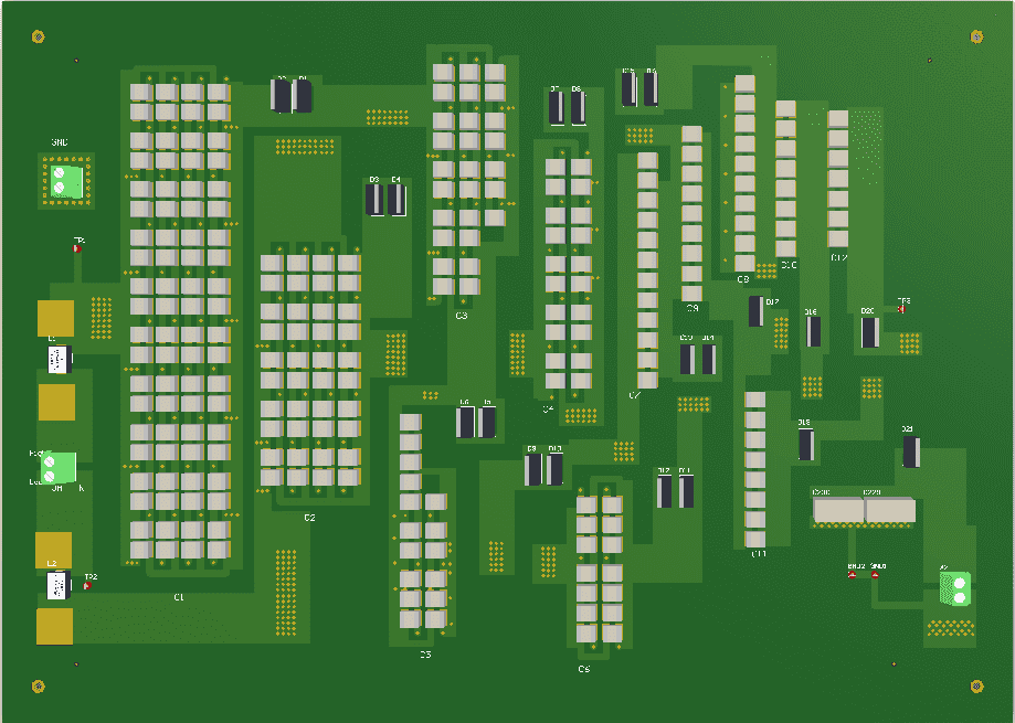

Schematics - only C-D block is published, driver block omitted. Inductors are not installed.
PCB - brown layer is top side, blue layer is bottom side. There is also equipotential layer ("ground plane") in the middle.

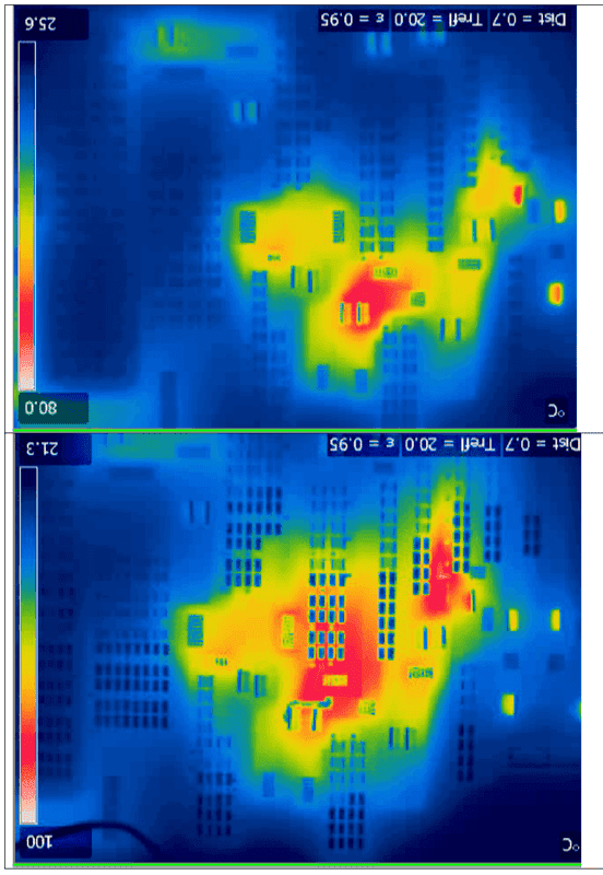

First thermal image shows untreated PCB with partial power applied. Second thermal image shows PCB with several "improvements" and full power applied. For improvement thick wire was soldered near D9-D10 diodes, which significantly reduced trace temperature in nearby region. (this wire is clearly seen in the image). Images are shown upside down to offset inversion made by IR camera.

It looks like the hot-spots are at feedthru holes. Try filling them with solder to increase their cross sectional area.

Thank you for help. According to my interpretation of thermal image feed-thru holes are at temperature lower than nearby trace. I therefore conclude that they are being heated by the trace. Filling solder into the holes did not made any difference.
OK, so much for that! Any chance there is problem with the Ground Plane in the hotspot regions? It obviously comes down to either the current is too high or there is not enough Copper. (Thin Copper perhaps from faulty board manufacturing?)

I think it'll be about the ground plane, since many hot spots/areas has no clear indication to existing traces (neither on top or bottom) on the PCB. But I don't have a good explanation yet.
Ps.: if you have a non-populated piece of that PCB and a good capacitance meter then could you please measure some track-to-ground capacitance around the affected area?

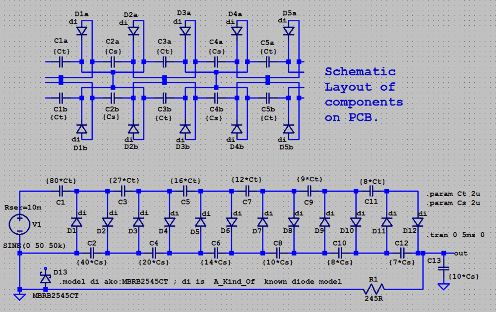

Looking at the circuit diagram, I see 12 triangular loops, each made from a capacitor with two diodes of the Villard cascade multiplier. Diodes are shared between loops. Each loop conducts in the alternate direction. You have built a 50 kHz ground plane induction heater.
I would expect the ground plane below those loops to conduct eddy currents due to the cyclic pump current. I have not been able to decode the exact layout yet, but it may be that some of those loops overlap, or are adjacent to return flux from others and so increase the flux and heating.
It may be possible to layout the multiplier as a transmission line, with the capacitor tracks on opposite sides of the PCB, so the loops have no area in the plane of the ground plane. It might be possible to deliberately overlap pairs of loops so the flux from the two loops cancel.
Alternatively you must remove the ground plane, or slit the ground plane into a comb or a tree.

I think maybe ground plane "smears" the hot spot. For example, if trace on bottom side overheats, it heats the ground plane and therefore we see it as bigger hot spot not exactly aligned with heat source.

I think it is a more likely possibility that the outer layers (between ground plane and the surface) smearing the heating of the ground plane.
This kind of localized heating can happen either by eddy currents or AC coupled to the plane by capacitance.
If you have the track-to-plane capacitance then calculating some current there might be possible (given you know the voltage levels there). But since the heating depends on the current, I think it's more likely to have something magnetic there. Try to apply a small full copper PCB in parallel with the hot areas and make a thermal picture of it. An eddy current should heat it up just like it heats up the ground plane.
You can try to apply some ventilation so it'll be independent to the heating of the ground plane.

I am no expert in this so please excuse me in advance.
The heated areas occur in places where the density of high current vias thru the groundplane is largest. Does this "threading" of the current back and forth not invite high induced circulating currents in the backplane, particularly in the areas immediately between alternating vias? This would seem to explain what you see.

Yes, I think these current loops are a root cause of the problem.
I doubt that (without heavy simulation) it would be possible to modify trace routing to prevent hot spots created by current loops.
Also I'm somewhat reluctant to remove or cut ground plane. It may resolve eddy current issue but at the same time create many other issues, including transmission line effects, resonance and EMI.
I planed to remove ground plane as last resort.
