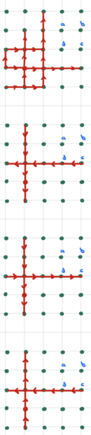

The following problem appears in Chapter 4 of Purcell's Electricity and Magnetism:
Consider a two-dimensional infinite square lattice of 1 ##\Omega## resistors. That is, every lattice point in the plane has four 1 ##\Omega## resistors connected to it. What is the equivalent resistance between two adjacent nodes? This problem is a startling example of the power of symmetry and superposition. Hint: If you can determine the voltage drop between two adjacent nodes when a current of, say, 1 A goes in one node and comes out the other, then you are done. Consider this setup as the superposition of two other setups.
My issue is that I don't really even understand the setup.
I had imagined that there would only be four possibilities for current flow in an infinite lattice, because of symmetry:
The reasoning I had was that in the horizontal direction, if the current flows into a node from the left, then it must flow into the node on the right so that that node has current flowing in from the left. Thus, the flow on the horizontal is always either from left to right or from right to left.
Analogous reasoning leads to current always flowing from south to north or from north to south. Thus we get the four possibilities above.
However, it seems that it is necessary to consider where the current flows into the infinite lattice and where it leaves.
The problem with this reasoning is that it breaks the symmetry. Why would the current flow left to right vs. right to left? Because of the symmetry, there's no physical difference in the two directions so there'd be no way for the current to decide to pick one direction over the other.
zenterix said:
My first question is: what is a "return lead connected around a rim very far away"?
If you were to build a large circuit, so big that "infinite" is a good approximation, you'd still need somewhere for the circuit injected at the node to eventually end up. That would be the return lead connected to the outer edge of the circuit.
zenterix said:
In the second scenario, where current comes in from infinity and leaves through ##N_2##, why can we ignore where the current is flowing in?
You're not ignoring where the current coming from. As you stated, the current is flowing in from infinity.
