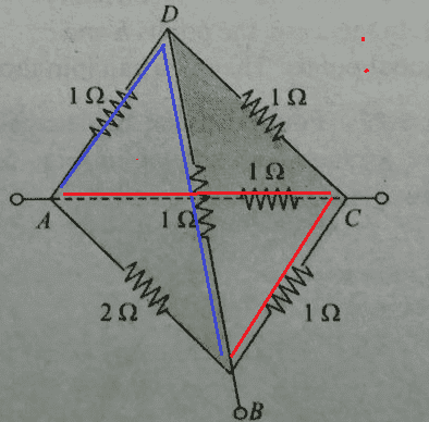

I am trying to solve this question by symmetry .If I draw a line perpendicular to the line joining AB then points C and D are symmetric . Now I am unsure how to proceed further .

Try to flatten the diagram: a top horizontal line is A, a bottom one is B. There are three paths from top to bottom: AB, ADB and ACB

I am interpreting that the circuit is already flattened out . The dotted lines are showing that branches AC and BD are not meeting anywhere .

The red path is out of the plane, but it is equivalent with the blue path otherwise.What does that tell you about the potentials at D and C?

If I draw a line perpendicular to AB , the left and right parts are mirror image , this make points D and C symmetric . But symmetric points do not necessarily have to be equipotential . Right ?
How can then we argue that points C and D are equipotential .

What would happen if you interchanged the blue and red triangles, would be anything different?

If you simply followed @BvU's suggestion to redraw the circuit in a single plane, the symmetry is easier to see, and the answer becomes obvious.

I am not saying that the circuit is not symmmetric . All I would like to understand is that why points D and C are equipotential .
If you remember in the previous thread you had given a very nice symmetry argument . But points L and Q , although being symmetric were not equipotential .
Please help me understand why D and C are equipotential in this problem .

Redraw the circuit as @BvU has suggested. Then you will see it.
We're not saying that you're saying the circuit doesn't possesses a symmetry.
In analyzing a circuit, one of the most useful tools you have is redrawing the circuit in a way that it's easier to work with. I'm not sure why you're so resistant (pun not intended, but I'll go with it) to the idea.

And in this case, also, redrawing the circuit does not change it.
There are 2 different situations.
1. You permute some or all of the nodes in the circuit, and you end up with the same circuit.
In this case, if a permutation sends a node to any other node, the voltage of these 2 nodes must be the same. That is the case here with C and D.
2. You permute some or all of the nodes. and you end up with the same circuit, but with the battery reversed. In that case if one point is at V, the other point will be at Vbattery - V. If the permutation does not move a point, it must be at potential Vbattery/2. This works for points C and D here as well. If
you swap A and B and not C and D you get the same circuit except for a reversed battery voltage. A and B swap between 0 and Vbattery and C and D are not moved by the permutation and must be at Vbattery/2.
In general this kind of problem isn't about rotational or mirror symmetry at all, but you just need to check if you can exchange 2 (or more) points and keep the same circuit.
You can do this if the connections from these 2 (or more) points to the rest of the circuit are the same.
In this case Rca = Rda and Rcb = Rdb, and these resistances are all of the connections from CD to the rest of the circuit.
If you draw the adjacency matrix of the circuit, you can exchange columns C and D and Rows C and D and you end up with the same matrix.

The oeiginal circuit cannot be drawn in-plane, but it has a mirror plane of symmetry (the yellow plane)The rectangles are the resistors Quite bad picture, but I hope you understand.
