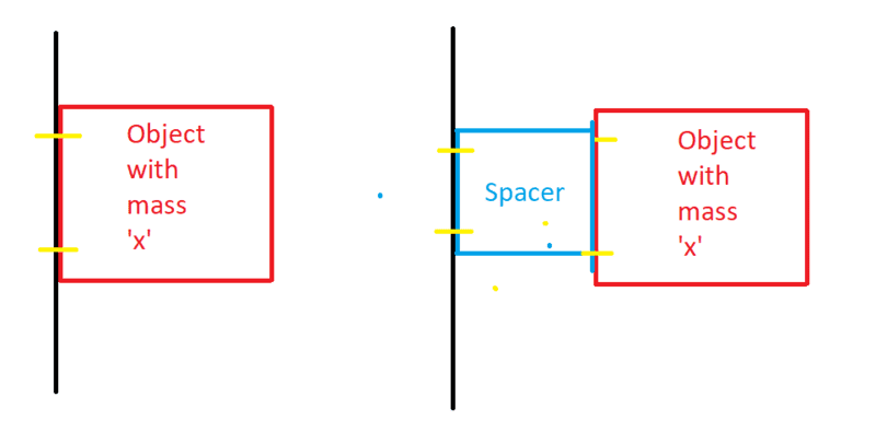

I want to know how to calculate the effective weight if i have an object with the weight 'X' that is mounted from the side to a wall, and what happens with the weight if i increase the distance between the wall and the object.
The reason i ask is as follows for the interested.

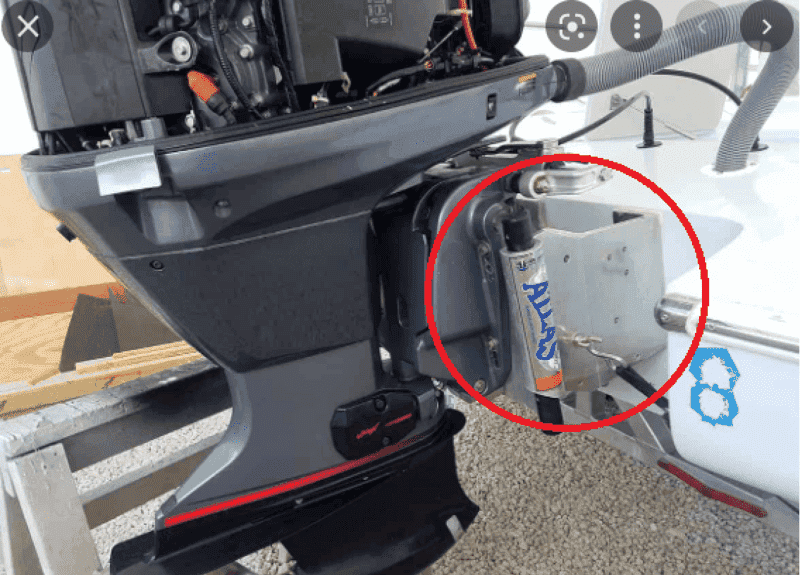

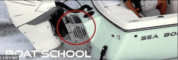

I have a boat with outboard motor. Now i have ordered a jackplate. This is a bracket that mounts between the outboard motor and the boat (also called a setback or spacer). In other words, instead of being directly mounted on the boat, the motor moves further back from the boat (6 inches to be precise).
I want to know how this setback affects the pulling force on the boat and to calculate the effective weight of the motor when it is mounted on a setback 6 inches from the boat. What would the equivalent weight be approx. of the weight would be if the mass is directly mounted on the boat.
I know the weight of the motor stays the same offcourse and it is the torque that changes. But an object that is further away from the body is heavier then a object that is close to the body.

There will be a slight increase in torque or moment. It will be dependent on the distance of the motor from the centre of buoyancy of the hull.
When you introduce the spacer, the boat will drop at the stern, while it rises at the bow. The neutral point, that remains the same, is the centre of buoyancy.

What was your reason for adding the jackplate? Something to do with water flow to the propellor around the hull? Are the faces of the jackplate parallel (i.e. is there any change of angle of thrust from the screw?). Everything can make a difference and mods need to be justified (apart from the salesman's pitch)

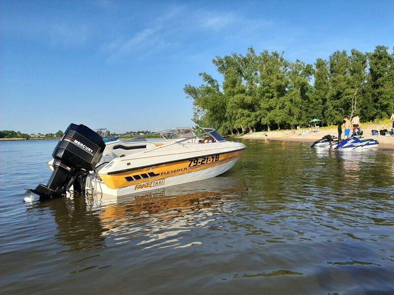

See here a image of the boat with old motor. I taken back my 5cm comment. Its more like 12 - 15cm
The distance from the COF of the motor to the planet where its mounted is approx 30 - 40 cm
Again, we can stand on the rear with 2 persons (approx. 160kg) and it would be fine
My theory is that i have 60kg more weight, + an extra "40 kg" because of the distantie of the motor (but that's the question i asked here). So that would be 100kg more at the end of the transom. But that's all based on assumings.
