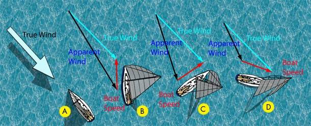

The answers to headwinds and tailwinds are yes. I'm a sailor, and I experience those feelings every time I go sailing.
Most dramatic. If your boat moves forward at 5 knots, with a 5 knot tail wind, you experience zero wind. If the tail wind was 10 knots, then you feel the wind passing you from behind.
Yes you do feel cross winds, but I don't know how to interpret your question. But there is a thing called apparent wind, which is the wind you feel based on the combination of your motion and the wind speed and direction.
xy.php?image=http%3A%2F%2Fwww.nauticed.org%2Fblog%2Fwp-content%2Fuploads%2F2009%2F02%2Ftrue-wind.jpg

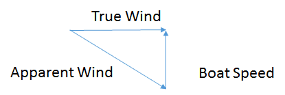

You should do the vector calculation and work with the relative wind. This is the "True wind" described above by @anorlunda .
CORRECTION: The relative wind is the "Apparent wind" described above by @anorlunda .
Thanks everyone. The apparent wind was what I meant by cross winds, and I found out how to calculate the speed for that.

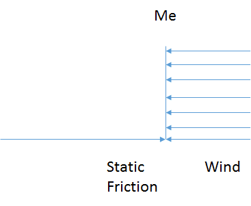

Not sure what I'm missing. Below is meant to be a back or front view of me walking on a treadmill with a fan at 90 degrees to the treadmill. The reaction force that keeps me from sliding off the treadmill sideways seems to me independent of what speed the treadmill is set to, and only dependent on the fan power.

Try a top down view, with all the velocity vectors. And what does a treadmill have do with all this? Just have someone walk on the sidewalk.
The vector diagrams in #3 apply to you as much as to a boat. They also apply if the magnitude of true wind is zero.
Remember, your speed is the direction your body moves, not the way your nose is pointing. You can rotate your body to any angle relative to your motion.
A treadmill generates no headwind in still air, so its easier for me to visualize all of the forces.
If I am standing still, its even easier to picture, or even easier to overlook whatever I am overlooking.
If I am standing still and a fan turns on to my right, I am pushed to the left by whatever force the fan wind is hitting me with.
Now, if a second fan is turned on directly ahead of me, I can't see how that changes the force that is pushing me to the left. They are perpendicular to each other.
If I start walking forward towards the fan in front of me, I increase the headwind force but I still can't see how I am changing the cross-wind force with my motion that is perpendicular to the cross wind.

A person walking on a sidewalk and not slipping will not be moved by a crosswind (or any wind, as long as they are not slipping). I am drawing an analogy to an anchored boat being similarly prevented from being moved by the wind.
Picture a person on ice being blown sideways by a fan, and change the picture to a person standing still against the wind on a sidewalk being blown by a fan. The vector diagrams for these two situations a different. Do you agree?

You are confusing the forces acting on the person with whether those forces move the person or not. An airplane or a boat can navigate a straight path from point A to point B regardless of cross winds by simply adjusting the direction the nose points. It is incorrect to say that the plane/boat is anchored to the A-B line, they achieve it by compensating for the side forces.
Ah. I get it now, thanks. If I think of the static friction on a sidewalk as a self-adjusting engine then it clicks.

The analogy is between a moving person and a moving boat. They will both experience the same apparent wind from a true 90° cross wind, but it's magnitude is not the same as the true wind.
The piece I was missing I think is that to make situation equivalent I need to add an engine to the boat that prevents it from being moved in the direction of the crosswind. Then the vector diagrams become the same. Thanks for your patience.
Sail boats don't need engines for that, just a keel.
If the below is correct, then I get it. I was definitely confused.
edit: Which is just case c in the earlier post. Sigh.
