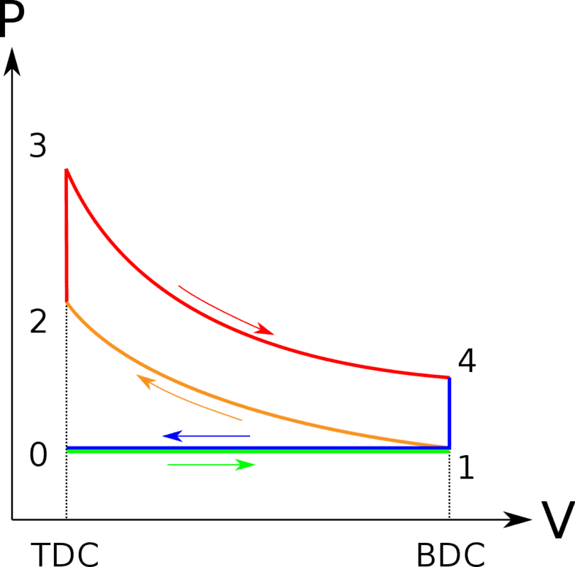

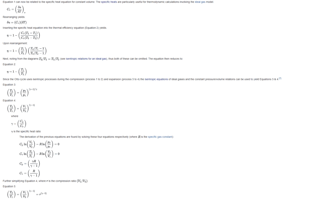

So we know that every reversible engine working between the same temperatures will have the same efficiency(the same as Carnot engine). So let's consider for example reversible Otto cycle. So as you can see on the picture it is operating between ##T_1## and ##T_3##, so I was thinking that it should have efficiency ##f = 1 - \frac {T_1} {T_3}## Below there is a derivation assuming reversibility(Indeed it is reversible there is no entropy increase), however we don't get Carnot but: ##f = 1 - \frac {T_1} {T_2}## which is lower. How is it possible?

They are different efficiencies! What you refer to is better stated that every reversible heat engine working between two heat reservoirs ##T_H## and ##T_C## have the same efficiency, the Carnot efficiency. This is what pertains to Carnot's theorem, that ##\eta_{CE} \geq \eta_{X}## with the equality only holding if the engine ##X##, which also operates between two temperatures ##T_H## and ##T_C##, is reversible. The Otto cycle is a different type of cycle which operates between different configuration of reservoirs.

That is not true. Reversible engines do not necessarily have the same efficiencies. And the Carnot cycle provides an upper limit on the efficiency that any classical thermodynamic engine can achieve during the conversion of heat into work. (Wikipedia)

That is fine, but statement you quoted is true if we make the assertion that the heat engine necessarily operates between two heat reservoirs.

Ok, now I see that indeed reversible engines would have the Carnot efficiency only when working between 2 heat reservoirs at given temperatures. And with different temperatures this argument of reversing cycle and using to produce additional work just doesn't work.
