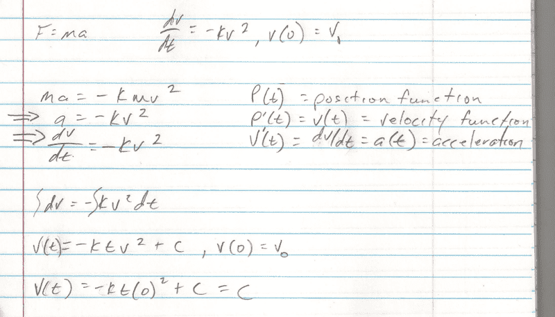

No. When you go from[tex]\frac{dv}{dt} = -k v^2[/tex]
to:[tex]\int dv = -\int k v^2 dt[/tex]
you can't simply integrate the right side as though v is a constant, because v depends on t, and you don't know the functional dependence of v on t. What you need to do is collect the terms in v on one side and the terms in t on the other side so you have: [tex]\int \frac{dv}{v^2} = -k \int dt[/tex]Try going from there.

What about the constant of integration and the initial conditions?

No! You need to add the constant of integration when you integrate, before you invert both sides.

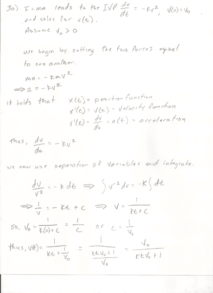

No: as phyzguy said, the correct statement is ##-1/v = -kt + C##.
Yep, I got that. So, v(0) = -1/C
Yes, so keep going. Now you should be able to answer the other questions.

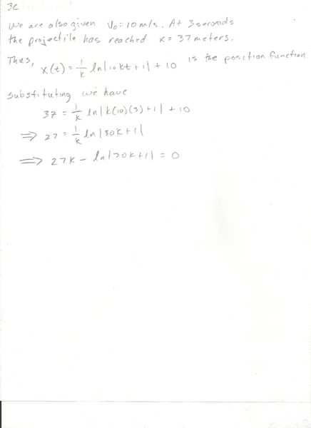

I now have to approximate the root of K. I'm not sure how to find a starting bracket. I know one way is to turn the equation F(k)=27k - ln abs(30k + 1) into two equations; y = 27k, y = ln abs(30k + 1). I've graphed it but the only intersection I can find is at the point (0,0), which we do not want. Any words of wisdom? Thanks!
I suggest using Newton's method to find the value of K. It works for finding roots of an equation of the form F(x) = 0. Here you have F(k) = 27k - ln(30k+1) = 0. Start with a guess for k (I tried k = 1) and iterate until it stops changing. What value do you find for k?

In this case you want to find the intersection of the two curves ##f(k) = 27 k## and ##g(k) = \ln |30 k + 1|##. For ##k \geq 0## (actually, for ##k \geq -1/30##) you can remove the absolute-value signs in ##g(k)##. We have ##f'(0) = 27## and ##g'(0) = 30##. Since ##f(0)=g(0)=0## and ##g## has higher initial slope, ##g(k)## will exceed ##f(k)## intially. However, since ##g(k)## is a strictly concave function on ##(0,\infty)## (i.e., ##g''(k) < 0## for ##k > 0##), and since ##g## does not grow very fast, the two graphs must cross again exactly once at some value of ##k > 0##. However, that ##k## will be very small, because already by ##k = 1## we have ##f \gg g##. As phyzguy suggested, you can use Newton's method, but another way that looks promising is to expand ##g(k)## as an order-2 Maclauren series of the form ##g(k) \approx 30 k - c k^2## and then solve the resulting quadratic equation.
The graph of ##g(k)## for ##k < -1/30## is a mirror-image of that for ##k > -1/30##, so as ##k## decreases below -1/30 the graph rises up again (from ##-\infty##) and eventually becomes positive once more. That means that there must be a second root at a value ##k < -1/30##.
