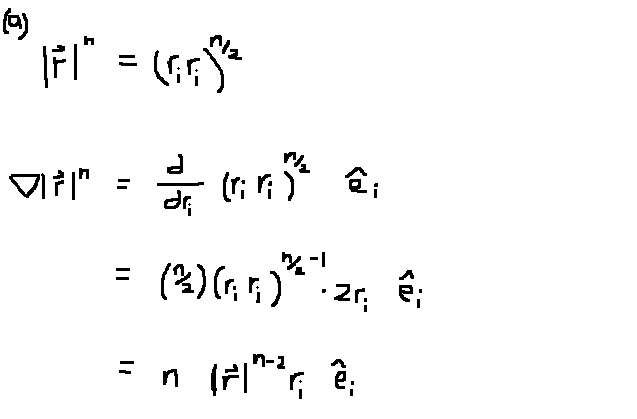

11(a)
Handwritten derivation labelled (a): |r|^n = (r_i r_i)^(n/2), then the gradient of |r|^n computed by the chain rule as n |r|^(n-2) r_i e_i, using Einstein index notation.

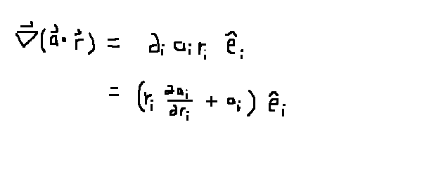

11(b)
Handwritten tensor-notation derivation of the gradient of a dot product: the gradient of (a dot r) equals a_i a_i,r_i e_i, then equals (r_i (da_i/dr_i) + a_i) e_i, with index sums written out.

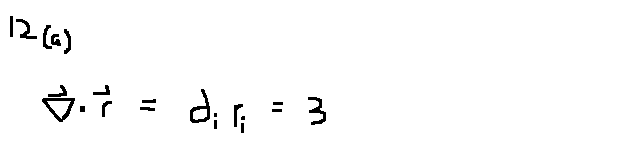

12(a)
Handwritten working for question 12(a): the divergence of vector r written as nabla dot r, equal to d_i r_i = 3.

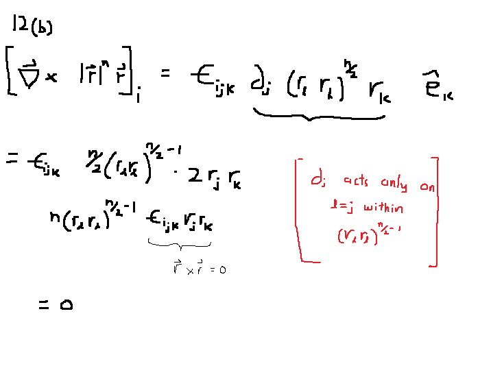

12(b)
Handwritten working in index notation: |r|^n r equals (r_i r_i)^(n/2) r_i e_i, then divergence of |r|^n r computed step by step to give |r|^n (3 + n).
Handwritten derivation of part 12(b) in index notation: the i-th component of curl of |r|^n r equals epsilon_ijk d_j of (r_l r_l)^(n/2) r_k, then becomes epsilon_ijk (n/2)(r_l r_l)^(n/2 - 1) times 2 r_j r_k, which reduces to zero because r cross r is zero.

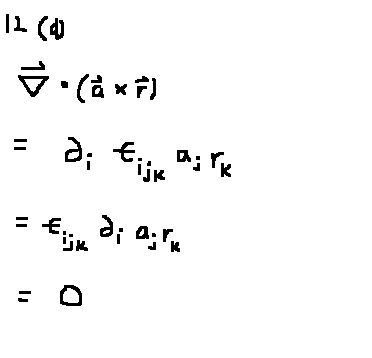

12(d)
Handwritten derivation of the divergence of a cross product in index notation: nabla dot (a cross r) equals partial_i epsilon_ijk a_j r_k, then epsilon_ijk partial_i a_j r_k, then 0.

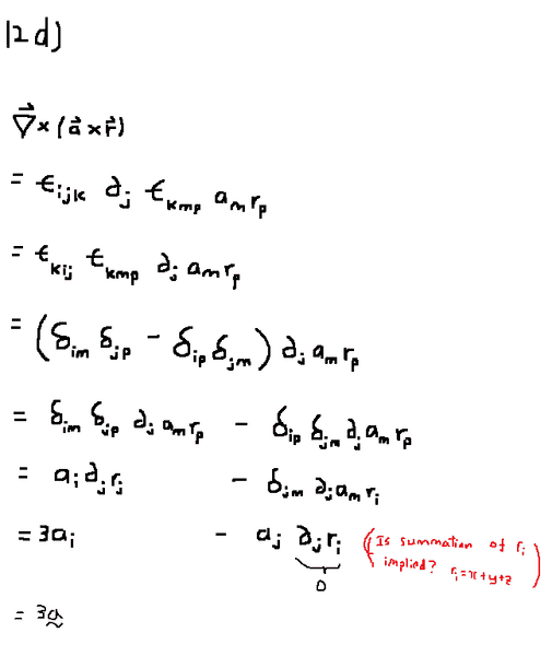

Handwritten derivation in index notation of the curl of (a cross r), reducing step by step using the epsilon-delta identity to 3a_i minus a_j d_j r_i, with a red note asking whether summation of r_i is implied, and the final line 3a.
(I did the last part of 12(d) by normal vector methods and got 2a instead...which is the correct answer)
An index shouldn't appear more than twice. For the first one, for example, you should have
$$\frac{\partial}{\partial r_i} (r_j r_j)^{n/2}$$

Thanks for your reply!
Also, I can't see what's wrong with my final answer in part 12(d)...i think the last line is the cross product of ∂j and r which equates to zero??
I think I have figured out every question other than part 12(d)
Hint: ##\partial_i r_j = \delta_{ij}##. You can use that in several of the problems. In 12b, you need to use the product rule.

thanks i think I've sorted it out!
unscientific said:
what does this mean? is it a vector or a scalar? summation implied or not?
It is not a summation. It is just the statement that the partial of the jth coordinate function with respect to the ith coordinate function is just the kronecker delta.
