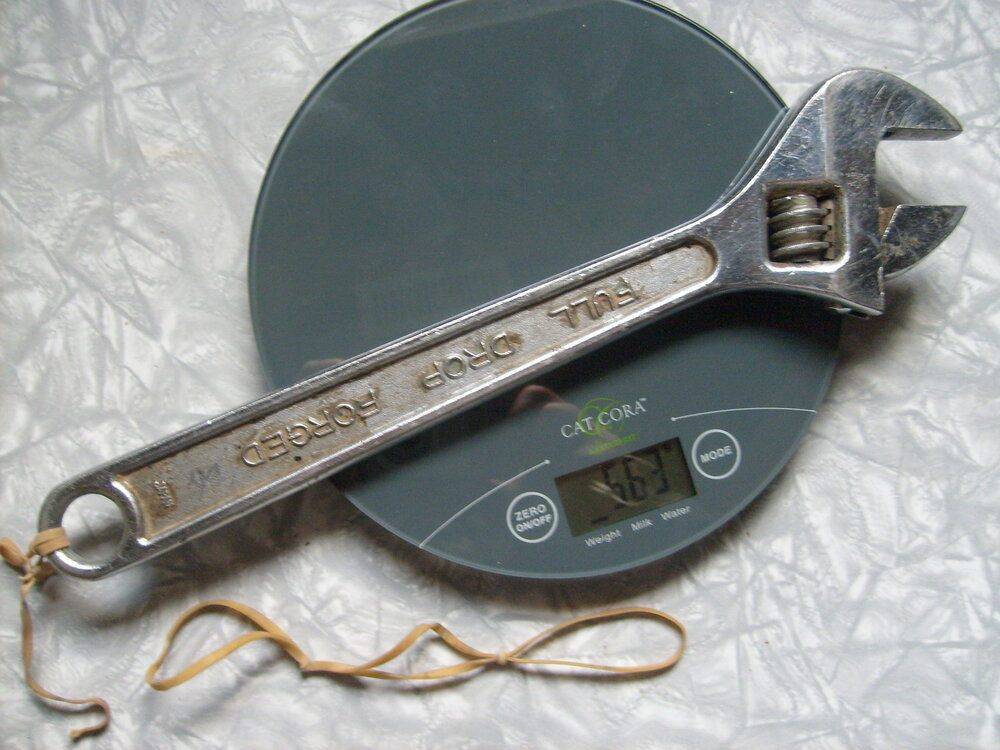

In the first couple of hours (from original stretched length ~87 cm of 5 bands looped to make a chain) it stretched ~6 cm and after a few days another ~10 cm. It still bounced up and down nicely. What do we mean by "elasticity", exactly?
(The next day it had broken.)
There are no language police. Words like elasticity can mean whatever the author wants.
That is not a simple question. If you really want to know more, you can search elastomer mechanical properties modulus creep. This hit is a good overall look at elasticity of rubber bands and other elastomers: https://apps.dtic.mil/dtic/tr/fulltext/u2/273880.pdf. It's a little old, but the information is still good. Figure 2.2.1 shows a simple model for the response of elastomers that gives an idea of why this is not a simple question.
If you really want to learn more, search elastomer material models. If you start to feel like you are trying to drink from a fire hose, you are.
