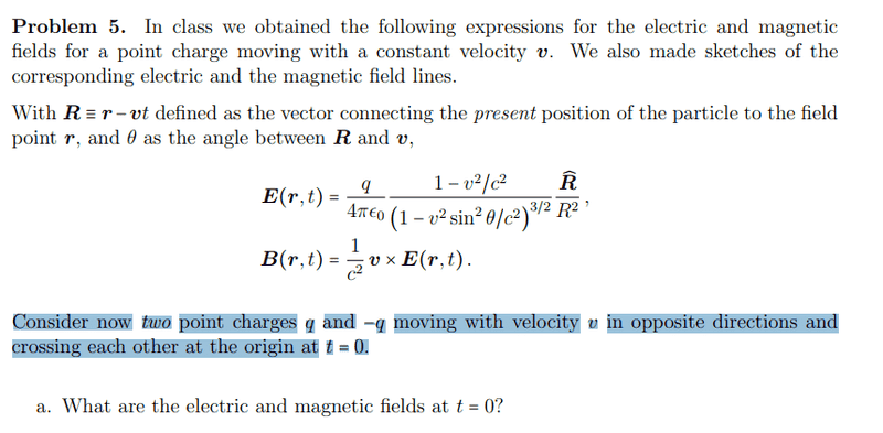

Say two point charges q and −q moving with velocity v in opposite directions and
crossing each other at the origin at t = 0.

Part a)

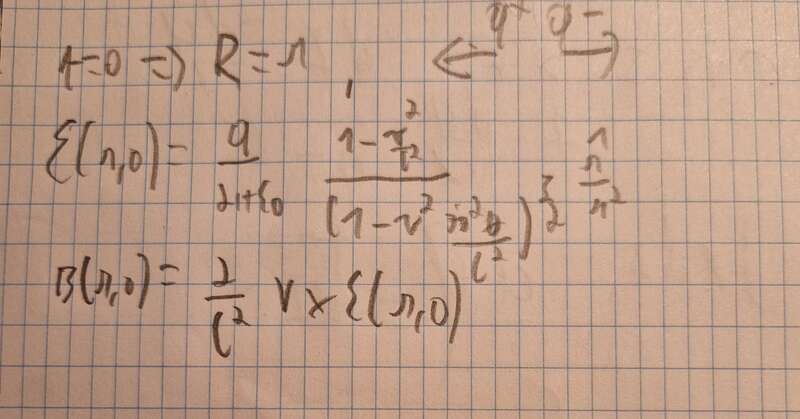

My solution:
Big R basically becomes r, and the electric and magnetic field lines are doubled because of superposition principle. Am I right?

Not so fast. What are ##\mathbf{\hat{R}}_1## and ##\mathbf{\hat{R}}_2## for the two particles? Yes, there is superposition but you have to do it formally, not "basically."
The two particles are oppositely charged. Would both the electric and magnetic fields double compared to the case of the single particle?
Yes since they're going opposite directions, if they were at same direction, it wouldn't.

Consider the formulas you provided in the first post for the electric field ##\mathbf{E}## and ##\mathbf{B}## of a single point charge ##q## moving with velocity ##\mathbf{v}##.
Would the direction of ##\mathbf{E}## at the field point at time ##t = 0## change if the particle moved in the opposite direction (but kept the same charge ##q##)? Would the direction of ##\mathbf{B}## at the field point change at time ##t = 0## if the particle moved in the opposite direction (but kept the same charge ##q##)?
Would the direction of ##\mathbf{E}## at the field point change if the particle's charge was switched to ##-q## with no change in direction of velocity? Would the direction of ##\mathbf{B}## at the field point change if the particle's charge was switched to ##-q## with no change in direction of velocity?

You stated that the B-field at the field point for the two charges at ##t = 0## would double compared to the single charge. That's right.
But it looks to me that your mathematical expression for ##\vec B## for the two particles that you wrote in post #1 is quadruple the field of the single charge.
milkism said:
My solution:
Your expression for E(r, 0) is twice that for a single charge. But you include an additional factor of 2 when writing B(r,0).

Oh yes! Didn't see I meant to write double mathematically.

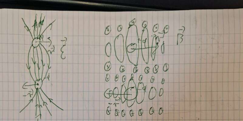

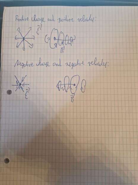

Hey, don't know if I should make a new thread, but the next question is part b of the problem. It just asks to sketch the magnetic- and electric field lines of the moving charges before or after they cross each other. This is what I got:
For the positive charge, the electric field lines ofcourse "move away" from the charge, and the magnetic field lines make a circulation around the charge, for the positive charge in positive direction the magnetic field lines will first go out the page then go inside the page, because of the right-hand rule.
For negative charge and negative velocity, it would be just the other way right?
Are they asking for a sketch of the net electric and magnetic fields due to both particles?
I don't think so.

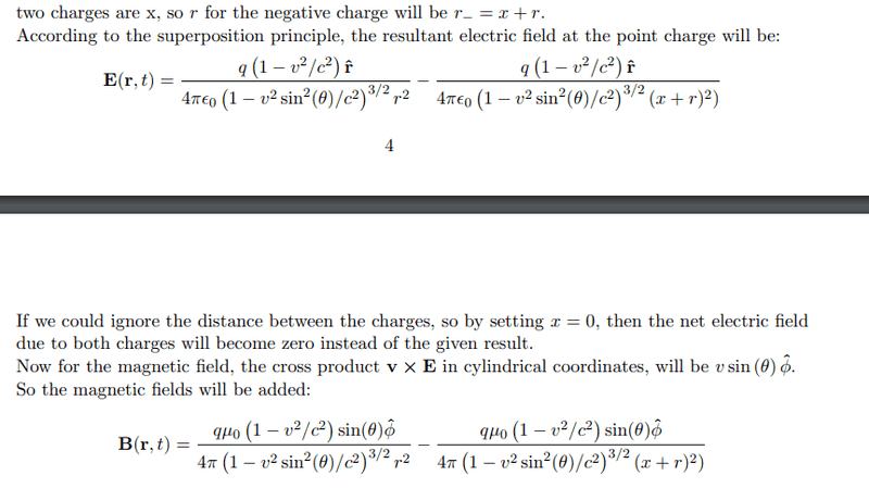

Sadly we may not, so my new equations became
For B(r,t) it should be + instead of -, my fault. Are these right?

It's net, this is what I got

Correction at cross product $$v\sin(\theta)E\mathbf{\hat{\phi}}$$

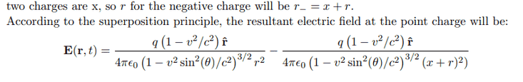

Please type in your posts rather than post your discussion as images. Otherwise, it isn't easy to quote specific parts of your post. Posting images of diagrams is fine.
If the net electric field is not zero at the instant t = 0 when the two particles "cross", then I don't understand the setup of the problem. You say that Enet = 0 is not the "given result". If you can state the given result, it might help us interpret the setup.
You stated the following:
What does it mean when you say "two charges are x"? Your formula for ##\mathbf{E}(\mathbf{r}, t)## must correspond to some configuration of the two charges. Can you post a carefully sketched diagram that shows the location of the two particles at the instant that corresponds to your formula? On the diagram, please indicate the location of the two particles and the location of the field point. Also, please label the quantities ##x##, ##r##, ##\hat {\mathbf{r}}##, and ##\theta##.
"The distance between the two charges are x" was the full sentence. The given result is just the expression I got for E(r,t).

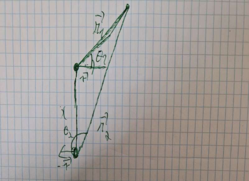

When drawing the figure I just realized $$\mathbf{r_2}$$, which connects the negative charge to the field point is not $$\mathbf{r_1}+\mathbf{x}$$. That would have been the case if the field point were to be right above the charges, with both angles being zero. Finding an expression for $$\mathbf{r_2}$$ will be difficult, so I will just leave it as $$\mathbf{r_2}$$. So the electric-and magnetic field lines will look like:
$$\mathbf{E}(\mathbf{r},t) = \frac{q \left(1 - v^2 / c^2 \right) \mathbf{\hat{r_1}}}{4 \pi \epsilon_0 \left( 1 - v^2 \sin^2 (\theta_1 )/c ^2 \right)^{3/2}r_{1}^2} - \frac{q \left(1 - v^2 / c^2 \right) \mathbf{\hat{r_2}}}{4 \pi \epsilon_0 \left( 1 - v^2 \sin^2 (\theta_2 )/c ^2 \right)^{3/2}r_{2}^2}$$
$$\mathbf{B}(\mathbf{r},t) = \frac{q \mu_0 \left(1 - v^2 / c^2 \right) \sin(\theta_1) \mathbf{\hat{\phi}}}{4 \pi \left( 1 - v^2 \sin^2 (\theta_1 )/c ^2 \right)^{3/2}r_{1}^2} + \frac{q \mu_0 \left(1 - v^2 / c^2 \right) \sin(\theta_2) \mathbf{\hat{\phi}}}{4 \pi \left( 1 - v^2 \sin^2 (\theta_2 )/c ^2 \right)^{3/2}r_{2}^2}.$$
I guess.
