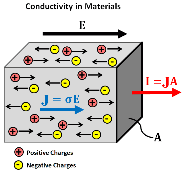

  • Diagram titled Conductivity in Materials: a block with electric field E pointing right, positive and negative charges drifting in opposite directions, current density J = σE in blue, and current I = JA in red through face A.
The diagram you show is for a resistor, not for a good conductor such as a wire.
Where did you find that diagram?
See: The Big Misconception About Electricity.

First, the electric field is not necessarily conservative, but let's forget about this and consider a simple circuit without (explicit) magnetic components. To simplify further, let's consider a real circuit formed by a battery, some copper wire and a resistor.
Since copper has a finite conductivity, there will be an electric field inside the wires. It will be small, but it will be non zero. Typical value for 20 mA in a 1.25 diameter copper wire is about 20 uV/m (iirc).
The field will be much stronger in the resistor, in accordance to Ohm's law E = j / sigma, for example tens or hundreds of volts per meter.
The electric field inside wires and resistors will follow the direction of the wires and the resistive material. How is it possible? Because of the surface and interface charge that develops during the initial very fast transient when you close the circuit.
I am not getting into the battery because the field in there will depend on the particular chemistry and construction, but know that the surface and interface charge develops because the battery creates a separation of charges that is associated with and electric field in the space around it.
Once you reach the steady state where E_mat = j / sigma_mat for the various materials (copper, carbon...) you can easily compute the line integrals knowing that the field is oriented like the portion of circuit where you evaluate it.
The line integral inside the battery will give you the EMF, the line integral inside the conductor will give you a minimal ohmic loss (usually approximated to zero) and the line integral inside the resistive material will give you the voltage drop 'along' the resistor.
