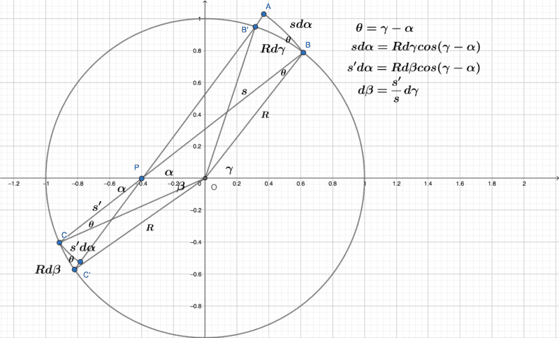

  • #33
I think we have done a serious mistake regarding ##\cos a##, it becomes negative for a specific range of ##\theta## so it is not always ##\sqrt{1-\sin^2a}## but it becomes ##-\sqrt{1-\sin^2a}## as well. This depends on the position of the point P.

@vcsharp2003, check the video by @Steve4Physics at post #45, it has a more clever way of calculating ##\cos a## than using sine law.
P.S it seems that even with the video approach we end up with the same result as at post #21, the only difference is that we don't need the absolute value as I had noted. It is of these strange cases in math where you do two mistakes and you end up with the correct result ,lol.

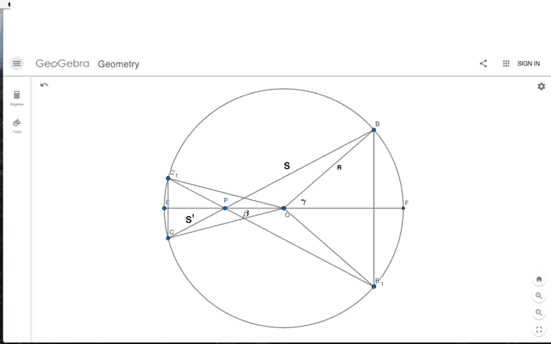

My strategy in answering the original OP is to start with the sphere and show how the differential element of the field at point P exactly cancels for opposing differential rings such as the rings through points ##BB_1## and ##CC_1##. Then show for the 2D case of a charged ring they don't cancel thus avoiding messy integrations.
We know the integration for the whole sphere cancels at P but is the assertion that corresponding pairs of differential ring elements defined by the chords ##BC## and ##B_1C_1## also exactly cancel true?
That's a good approach, but it would not be quite enough to show that the same choice of pairing does not cancel; you would need to show that for this or some other pairing the net field is always the same way.
