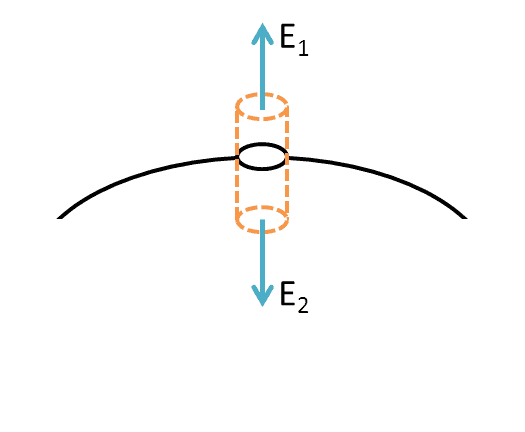

A hollow insulating sphere of radius R is charged uniformly to a charge of Q. There is a small hole on this sphere. What is the electric field strength at the centre of this hole?
I think I have to use Gauss's law here but what should be the Gaussian surface here? I am thinking of a small cylinder around the hole. Correct?
Please see the attachment.
##E_1## is the electric field just above the hole (outside) and ##E_2## is the electric field inside.
From Gauss's Law, ##E_1S-E_2S=0 \Rightarrow E_1=E_2##.
Am I going in the right direction? What should be the next step?

It is the electric field for the entire shell, but subtract the field due to the bit where the hole was.
Umm...I don't get this. Which electric filed are you talking about? ##E_1## or ##E_2##? How do I calculate the field to be subtracted?
Thanks!
There is only one electric field.
You want the electric field at a position in the middle of a hole in a shell of charges?
What would the the electric field at that position be if there was no hole?
How big is the hole?

I think I have to assume the hole as a disk of negative charge density ##-\sigma## where ##\sigma## is the charge density of sphere. If I place a small disk of negative charge density on a surface of positive charge density, it acts as a hole.
Electric field due to disk will be in direction opposite to that of the sphere. Hence, net electric near the hole is:
$$\frac{\sigma}{\epsilon_0}-\frac{\sigma}{2\epsilon_0}=\frac{\sigma}{2\epsilon_0}=\frac{Q}{8\pi \epsilon_0 R^2}$$
Though the above answer is correct, I would like to know if I solved the problem correctly?
You just used the superposition principle - which is a reasonable way to go about this.
Notice that adding (the field due to) a negative charge density is the same as subtracting a positive charge density? Thinking of the hole in the shell as an absence rather than a presence usually looks better on paper.
Can you express the result in words?
What is the effect of putting a small hole in the shell about a position on the shell, on the strength of the electric field at that position? i.e. does it make the field bigger or smaller? how much bigger or smaller? Is this surprising?
